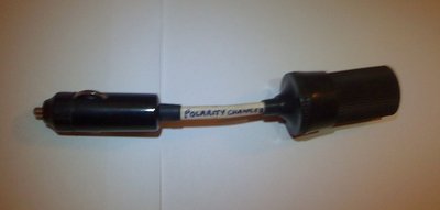

Have you retained positive earth? If so, is this mod simply a case of switching the wires around on the cigar lighter socket?Jack wrote:He then wired up the cigar lighter socket so that we can run sat nav, phone chargers etc as required on longer trips.
Former guardian of e3/sa/934 jowett jupiter mark 1
Re: Great SC rebuild.......
No, the dynamo and starter motor were reverse polarised. Petrol pump checked for non-polarised capacitor. Ignition coil connections reversed.
Also see http://jowett.org/jowettnet/dt/tech/mod ... rnator.htm but an alternator is not fitted to the SC
You could retain positve earth but would need to reverse and isolate the power socket.
The problem with retaining the positive earth is making sure that all appliances do not have their exposed parts 'live'. Such happened when doing the first Pirelli Marathon in 1988 when the video camera earthed onto the chassis. I had the camera in bits on the autostrada whilst navigating and replaced a melted wire.

I made this to be able to use things like cellphone chargers etc., when they are required in the Jupiter . . .You could retain positve earth but would need to reverse and isolate the power socket.
The polarity is swopped over in the wiring of the adaptor. The brass sleeve just inside the socket is now "live" of course, but it's back from the rim of the orifice and should present no problems, with a modicum of care and attention
It is suitably labelled and kept in the Jupiter's glovebox.

Another method, allowing you to retain positive earth, would be to simply swap the wires on the back of the socket as you suspect - we bought one that fitted the hole in the dashboard, and it was supplied like this:jondowning wrote:Have you retained positive earth? If so, is this mod simply a case of switching the wires around on the cigar lighter socket?Jack wrote:He then wired up the cigar lighter socket so that we can run sat nav, phone chargers etc as required on longer trips.
The two metal connectors on the back are what you need to wire up, you could just swap the wires onto these connectors to do that, in theory it would work with modern appliances, with caveat as Keith mentions above about how they are used. Things like sat nav should be ok, but worth being careful.
