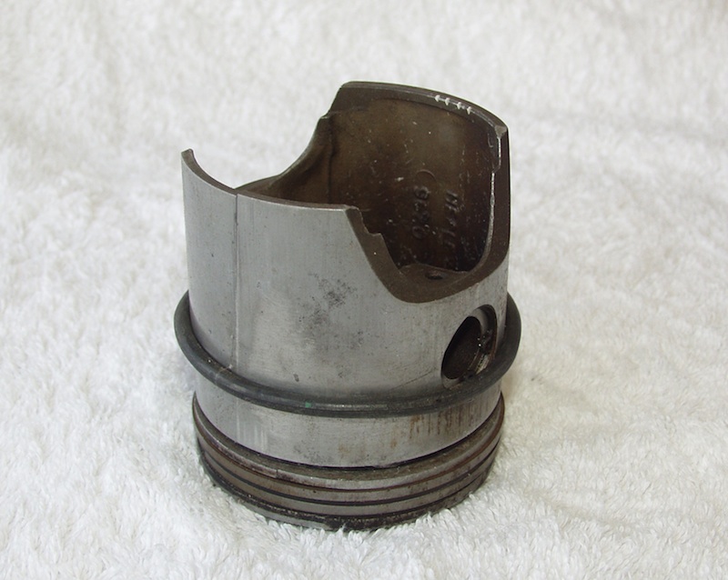

I thought I'd set the ball rolling with this tale of woe . . . or maybe it should be looked on as being a very lucky break* . . . .
The first image gives the impression of it merely being a picture of just a ordinary split skirt Javelin piston, without a oil ring and with a rubber "O" ring on the skirt . . . .
. . . and it is
Javelin piston with "O" ring
. . . . but take the "O" ring off, and . . . .

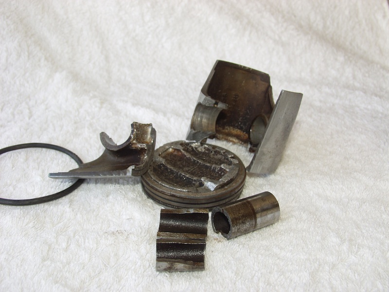

"Exploded" view.
"Exploded" view.

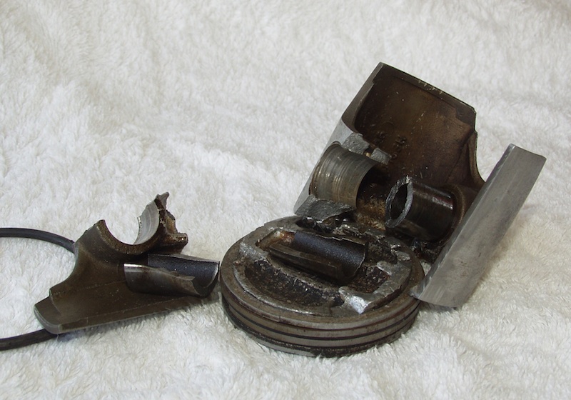

Piston broke and far from home . . .
* This happened to one of our family cars . . . . The driver will remain anonymous so as to protect the writer, but he/she told me that the car made a bit of a loud knocking sound, ran on 3 cylinders but kept running well enough to pull off the highway and into a lay-by a couple of hundred meters down the road. A phone call was made and the car was towed home. Miraculously, I found the head of the piston had proceeded to the top of the bore where it was pushed back a bit by the valve action, then shoved back again by the skirt. This must have happened several hundred times. The skirt, although broken in three, stayed together and attached to the gudgeon pin. The gudgeon pin in turn was in three pieces! The valves were not damaged, I seem to recollect. :o

An interesting story Leo.
Essentially the same thing happened to me in circa 1974. I was driving my Javelin the 60 mile round trip Guildford-London-Guildford every working day, when one morning on the way up the A3 to work - Bang! At this remove, I can't remember exactly what happened and how the issue was resolved. I believe that the noise was not too bad, so I was able to drive home where, like all good Jowett owners, I had a spare engine ready for just such an occasion and the rest of the day was spent installing that. The next day I was back at work.
When I examined the failed engine, I discovered that the piston had broken off cleanly around the oil scraper ring groove and that the crown had securely lodged itself up at TDC just out of reach of the rest of the piston, hence the lack of aural drama that allowed me to continue driving. In that respect I was very lucky, particularly as there was no other damage to the engine. Later, I replaced that piston with a spare and put the engine back in the Javelin and continued to drive it for a long time thereafter. I guess that piston crown separation is an occasional failure mode that we have to contend with.
