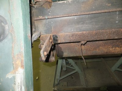

I've often wondered, why there are on both sides holder.
Can anybody say, for what they are intended?
Was that original?
Here a picture, you can see, what I mean:
Was that original?

Re: 1936 Jowett in Germany restore
Marcel
There are original
There are two L shaped brackets that bolt to these that support the rear bumper.
I have tried to put in an image but this system is not resopnding. I will Email them
There are original
Okay, thank you Peter!!
I don´t know, how Looks my car in ihr heck, orginally...
but I have a presentation, how my car will look in heck!
It will be a own creation!
Greetings
Greetings

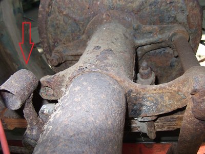

Pictures at Last
The second one is from under the car
Hello peter,
Thank you for showing the potos!
The last photo, you can see the spare wheel well?
Is that right?
Reguards marcel
Is that right?
Reguards marcel
- Posts: 140
- Joined: Tue Sep 02, 2008 7:45 pm
Correct. That is the spare wheel well. But for the Kestrel.
You have a Falcon, therefore the spare wheel is mounted externally and NOT within a compartment as the photo shows. Therefore you do not have the curved well as shown.
In photo 1 you can see the spare wheel cover. It is part of the body work.
Photo 2 is from the underside, as you have worked out

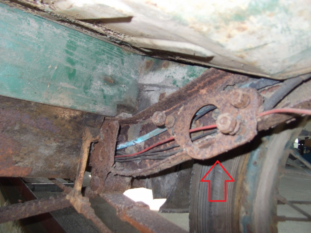

Hello,
I don´t know, what diese components means. Is there a art shock Absorber?
Here you can see pictures about my frame.
Has anybody a picture from this area of Jowett who is complete?
Thany you,
Kind reguards
Thany you,
Kind reguards
You only have the remains of the shock absorber which should be bolted to the chassis and connect to the linkage in the second picture. These should be 'Luvax' type shocks - are any present on your car?
- Posts: 433
- Given Name: peter
there ar in E-Bay a pair LUVAX shock absorbers
E-Bay Nr. 121183954423
peter
peter
