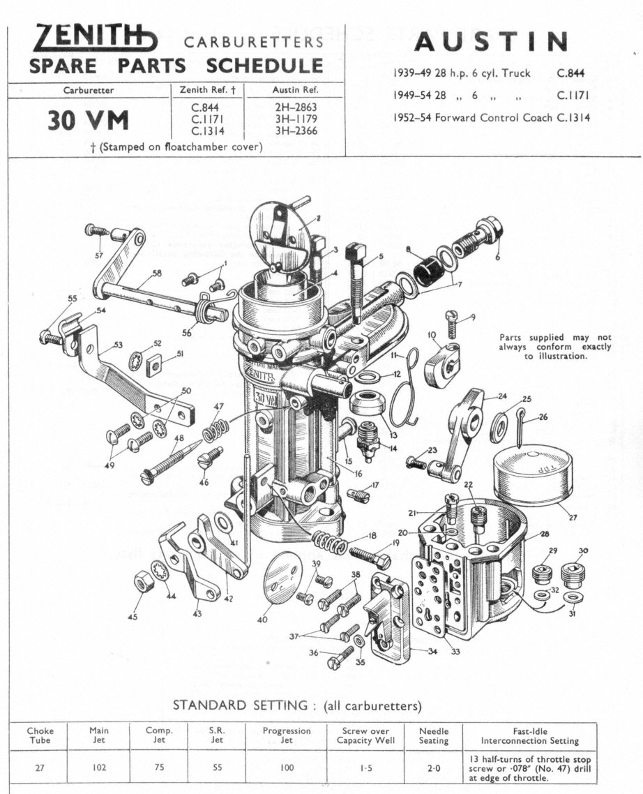

A number of people, including Jaak Jacobs in Belgium, have been suffering carb problems, so I sorted through my 50 spare (scrap) carbs at the weekend. I was surprised to find so many supposedly non Jowett carbs in the hoard. (C1074,C1344, C1343 , C855A, C1461, CS 1194.) They all did come off Jowetts so I guess they all must have worked.
I would be interested to know if anybody else has Zenith carbs with 'C' numbers diiferent from this official list.
Javelin Zenith Contract Sheet Number C1084 30VM-4, C1130 30VM-5, C1161 30VM-5, C1316 30VM.
Jupiter Zenith Contract Sheet Number C1245 30VIG-5, C1316 30VM.
Are any of the non-Jowett bodies and float chambers suitable in a Jowett? Or indeed would any actually be better with modern petrol and tuning?
Whilst doing this survey it would also help if you checked the jets in the carbs as they may have also changed over the years (they will have worn as well of course!)
See http://jowett.net/Parts/TechNotes-Part18-Zenith.htm for details of how they left the factory.
You may also like to see other Zenith carbs here. http://www.stationary-engine.co.uk/Zeni ... thCarb.htm and tell me if you find and equivalent.

I have just looked up on http://zenithcarb.co.uk/cf/vehicle/list ... le=Jupiter
Jowett Jupiter 1950 to 1951 C1245
Jowett Jupiter 1950 to 1953 C1343
Jowett Javelin 1948 to 1954 C1334
So I guess that explains some of the ones I have in stock.
I have not found what jet sizes these variants had though!

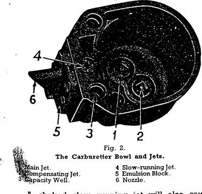

From Tech Notes part 13
For competition the following settings were recommended. The main difference is the larger choke size, up from 25mm. If the engine is balanced to give higher revs then an even larger choke size should be used, requiring a different body. The 30VM C1343 which was fitted to many of the Javelin engines I acquired had 110 main and 65 compensating jets. It is likely such changes may have resulted from further tests done after the Tuning Notes were published, or maybe they gave a more economical setting. Any ideas? The vent or capacity orifice was also fitted with a different size, either 2.5 or 2.6. Understanding how all these orifices interract is indeed a study for another day. Since I never used the Zenith in competition it has not been done by me before. But has anybody else...but will they tell?
Somehow a pair of 30VM C1627 were fitted to Amy's SC. So sometime soon I am going to investigate what is in them. I suspect they may not be correct. No idea what they came off.
From Competition Tuning Notes...
Carburettors – Special 30 VM. Carburettors with the following settings:
27 mm Choke; 110 Main Jet; 50 Compensating; 2.2 Vent over Capacity; 45 Slow Running; 120 Progression; 1.5 mm Needle Seating (1 mm Washer) should be fitted in place of the Standard VM. 4 or 5. These Carburettors are interchangeable and carry our Part- numbers ¬LH – 1.53732; RH – 1.53733.

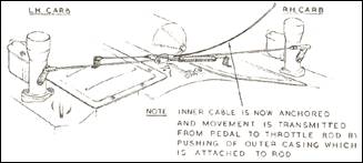

The Throttle Spindle operation is in the reverse direction, and the Throttle Cable must consequently be rearranged. A suggested method is to fit a Cable approximately 9”.(25 cm) longer than standard, securing the Inner Cable to the Bracket on the left hand Tappet Cover, and the Outer Cable to the Throttle Rod. The Throttle Re-turn Spring should be connected to the Clip to which the original Outer Cable was secured on the right hand Tappet Cover.
