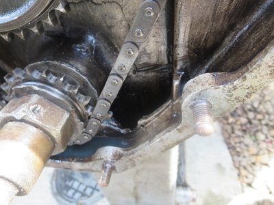

Inevitably (and I mean inevitably) taking the timing cover off revealed more damage. As Tony predicted, the case was badly bent at each nut and along the bottom edge, and the chain and sprockets are all badly worn. What did puzzle me is that the chain was completely dry and in fact the whole case seemed to be too.
How is the chain supposed to be lubricated? It looks to me as though it should run in an oil bath in the bottom where there does look to be a small hole, as George suggested. However, it also looks like a bit of the casting is broken off, so the bath can't fill to the level of the chain.
Does this look right? I wonder if it was broken when a chain snapped, or when someone was beating the crank nut with a chisel! I assume the washer behind the nut was a locking tab at one stage.

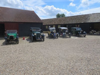

I'm pleased to report the distributor rebuild/ recalibration has transformed the engine and we have been out and about all weekend. Saturday saw a trip to Daniel Banham's place for "Coffee and Classics" and home made pizza from his wood fired Pizza oven. This was the first first time the car had been looked at by club members and they swarmed over it sparking lively debate as to what the hell it actually is and which bits came from where. Eventually, someone stood back and announced "It's just so wrong, it's actually right!" I'm pretty sure this is a compliment?? There were also many positive comments regarding the dented panel work, bent mudguards, mismatched headlamps laughable panel gaps, etc and universal consensus was I should stop where it is. I'm still working to get it mechanically 100% and get the hood sorted, but I'm happy the rest has been conserved as much as needed.
