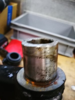

About my groaning noise and rumble at the front (suspencion)

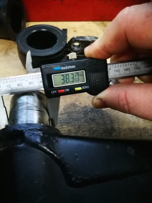

it should NOT to hammered on!!!! should have a little play so all the items will working free!!
the mesurementit should NOT to hammered on!!!! should have a little play so all the items will working free!!

it was a bit of work.... for the near side - no problem // but to the off side hade to losened the engine.....
now it ride very nice, no rumble and banging .... problem solved!!!

Metalastic bush too tight.
I think I might disagree with the diagnosis. Unless I am mistaken the trunnion bush should be an interference fit on both the spring arm and the bracket. See maintenance manual page 61 para 128 and read the special note at the very bottom for early cars. However, if it has fixed the creaking , I guess you are happy!
It is possible at some stage in its life the end was hammered to either get it out or put it in and making it parallel again is sensible. I do not recall it being an issue on assembly but then I did not see everything happening at the resto show and do not recall everything that happened before. However, getting the torsion bars out 5 years ago was a serious task and it is likely any damage occurred then.

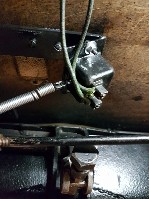

Fixing my Breakligth switch the swiss way, maybe a good solution....
