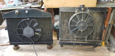

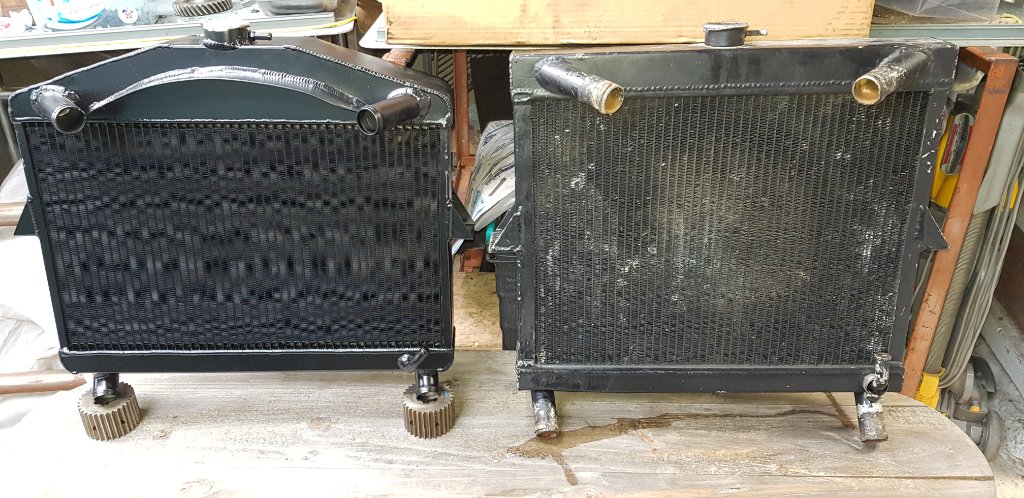

Note in the picture below I compared the two rads by having the mounting brackets at the same level. The one fitted in 1998 was made larger to give extra cooling for the Sahara desert rally. It had two problems. If the rad was set vertical, rather than being fitted to be in line with the fan, the bottom of the rad hit the gearbox selector knuckle. If set on the standard 1.5cm rubber mounts it hit the bonnet support tube at the top just above the water inlet. The rad did have about 20% more surface area so was thought necessary for the desert temperatures. We never got close to needing so much cooling!
I asked Coolex to make the rad to my dimensions rather than those of the original Jowett rad that I gave Coolex as a pattern. This overcomes both the issues although it could be about 3 cm taller, making the core size the same as the Saharan rad, as now there is a lot of clearance at the top of the bonnet with the bonnet gap parallel and even around the scuttle. This could not be acheived with the old rad. The front bonnet locating mounts were previously raised to stop the rad hitting the bonnet support tube.
The rad is half the weight of the original rad and beautifully made.
