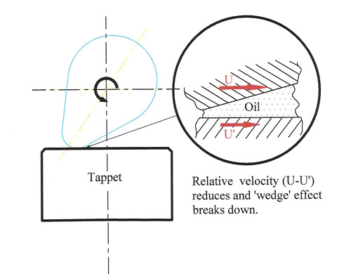

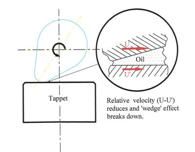

Another article explains how the critical time is where the cam lobe reverses relative direction as it goes over its high point thus loosing the wedge of oil lubricant. This is where ZDDP is so effective. But it also warns the oil temp needs to be above 60deg C to be effective.

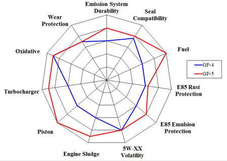

To carry the story on further this article explains some of the complexities of legislation and oil, summarized in this diagram.
