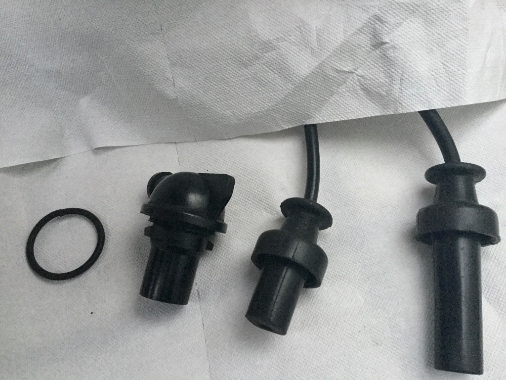

Re: Jupiter Spark Plug Caps
The Jowett spark plug covers can be used to give that finished appearance to the engine. I have used this mod with no
problems. Drill out the covers & insert a suitable modern waterproof cover, I used Honda plug covers as used on the
Rover 827, these are set using a good epoxy into the drilled covers, the job is easy using a cylinder head on the bench.
A soft rubber ring forms an additional seal between the head tin plate & the plug cover, as stated, cool, & correct for
appearance,
Alf
Hi Rick, a couple of pics, might help. Hope you rejoin the club.
Alf.
Alf,
Thank you. I will try to copy your idea.
