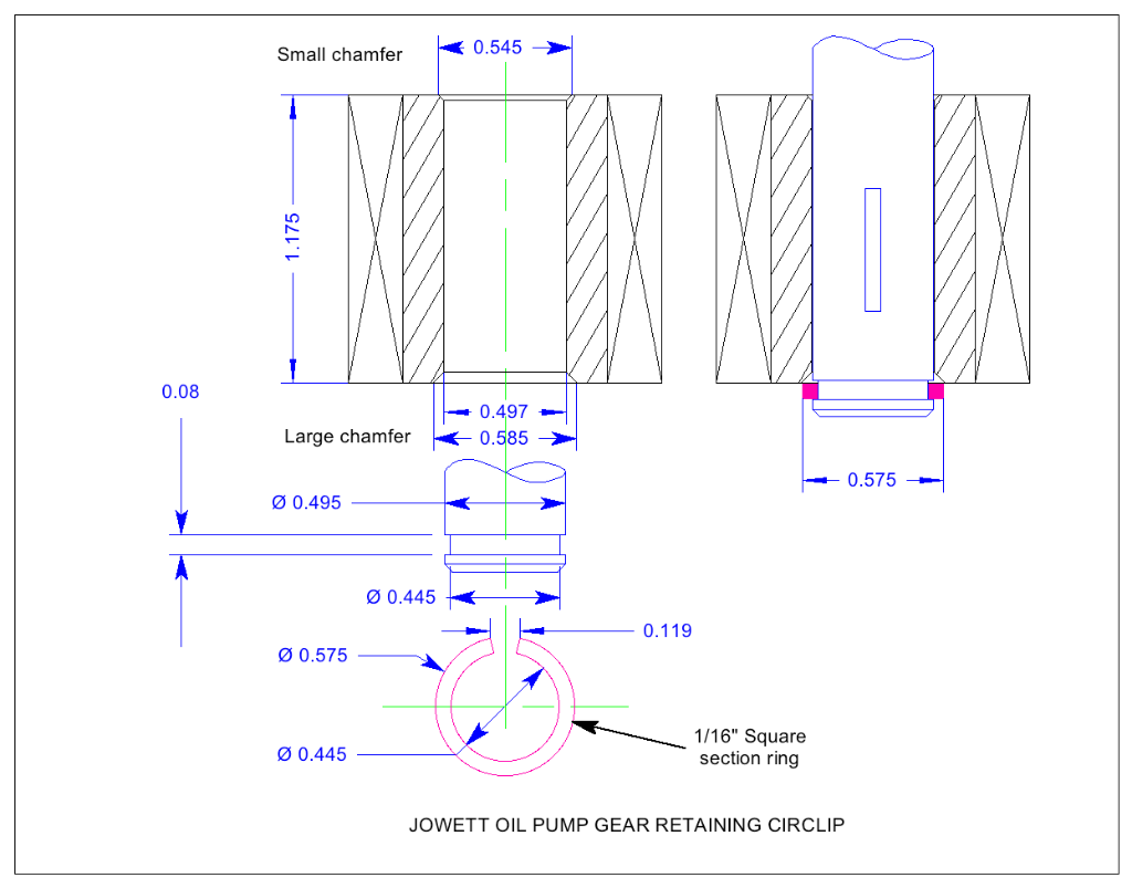

I have two oil pumps on my workbench at present, one of which is apart. From this disassembled pump, I can confirm that the spindle bore of both gears have a chamfer at both ends, but only the bottom of the driven-by-the-engine but driving-the-idler gear has the large chamfer. After taking dimensions of the parts, I made the attached dimensioned drawing.
Points to note: The retaining ring is made from square section [0.063"] wire. It does not seem very springy [highly technical term!], and when in its groove in the driving spindle, its OD appears to be smaller than the large diameter of the chamfer. It is almost as if the intent is for the chamfer to hold the ring into its groove; if so, it is not an elegant piece of engineering.

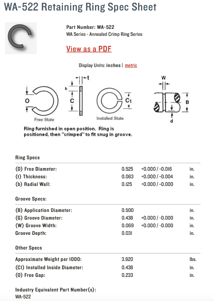

The ring appears to be similar to this WA-522 example from American Ring company [spec sheet attached], and you note that the ring is supplied in "opened" form, to be lated crimped onto the shaft. In this case, the WA-522 ring is a little too large on the OD for our purpose.
I still have no better explanation for the large chamfer required in that location other than to promote some flow of oil up the shaft. Remember that in use, the gear will be pulled up against the pump body which will make it difficult for any reasonable flow of oil to reach the spindle by that route.

My dimensions are similar but not exactly the same. There would be tolerances and also, I guess, aftermarket parts around.
I have been able to dismantle another pump and now I have seen gears with chamfers both ends. A closer look at some of mine make me wonder if there were originally very small chamfers on those which I thought were flat and where the circlips have chewed up the ends of the gears, perhaps due to the circlips binding on the 5/8 bore, for which there is some evidence, or getting the edge crushed into the chamfer.
My shafts were both OD 0.4985, groove diameters 0.435 and 0.438/9. Chamfers on gears were within 0.572/578 and one at 0.542.(roughly, so 3rd place is not reliable as I had difficulty measuring them, only have calipers, worsening eyesight and wobbly hands - old age creeping along!)
There is a square section external snap ring in GB catalogues, but so far I have not been able to locate any. Suppliers say there is virtually no call for most inch sizes over here. It is 0.062 x 0.062 and ID 0.461. I think this theoretically just fit inside the 5/8 bore (which is near enough spot on), even with movement in the smaller groove except that the base is not positively located on the body. I will use one if I can find any. Just by chance the shaft with the smaller groove so slightly more side play has the best gear on the upper end. Such is life. I have not heard of retaining rings which need to be closed onto the shaft. Maybe for light duty?
If the ring goes very slightly up into the chamfer, this will increase the vertical play which is enough on mine already with its 'soft' square ring which is wider than the chamfer all way round as I cannot close it further due to the bit of 'springyness' left in it. I have heard of people using a round snap ring but trying this with a ring cut from a suitable ID coil spring of 0.070 wire diameter I also found more vertical play than with a 0.062 square ring and I guess that the line contact above and below the ring would increase this play over time. A smaller wire diameter ring might give flat contact with the chamfer and the groove, but with yet more vertical play so I have discounted that approach.
I can understand that a chamfer might help oil flow up the shaft of the driven gear but to get oil up the keyway of the driver to oil the top face it would also have to get past a fairly well fitting key. Having said that, both of my pump bodies show most wear above the driving gear so more lube is probably needed.

On the two pumps that I have on my bench, the vertical end float of the drive shaft is around 0.017". Because of the helical drive gear, this end float could affect ignition timing; if the timing is set with the shaft "dropped down" as it were, the timing will retard slightly when the running engine lifts the shaft to its upper position.
I would not expect to see aftermarket parts associated with the Jowett oil pump, but there are clear differences between nominally the same parts, so I think that a lot of the variation is down to suspect Jowett manufacture.
