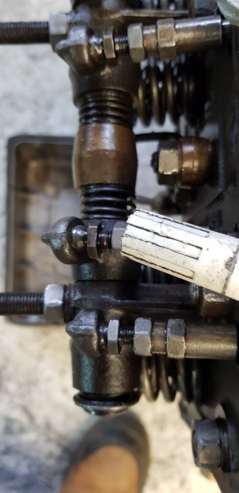

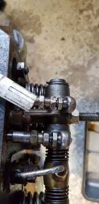

Set tappets.
Having seen how many experienced Jowett people incorrectly set tappets not only I but JCL recommends this technique.
March 1953 Item No. 131. Tappet Adjustment, Solid Type – Javelin and Jupiter
To clarify the instructions on tappet adjustment the following notes are issued. It is extremely important in view of the fine adjustment required that:
1. With the engine COLD the inlet clearance is set to 0.003" (0.076 mm) and the exhaust to 0.006" (0.152 mm) these dimensions being measured between the end of the valve stem and the rocker.
2. Ensure that the tappet being adjusted is riding on the base circle of the cam and NOT on the initial portion of the cam-quietening ramp.
Adjustment should be made to tappets according to the table shown below:

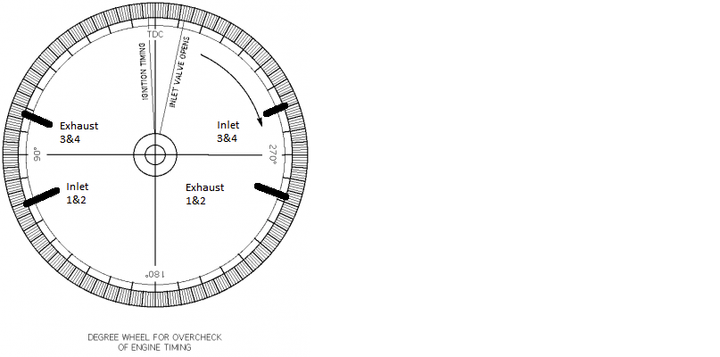

Setting Position of Engine, Valve to be Adjusted Pulley position of TDC mark on pulley (hour hand of clock)
Number 1 Exhaust valve fully open , Number 2 Exhaust , 8:30
Number 1 Inlet valve fully open , Number 2 Inlet , 3:30
Number 3 Inlet valve fully open , Number 4 Inlet , 9:30
Number 3 Exhaust valve fully open , Number 4 Exhaust , 2:30
Number 2 Exhaust valve fully open , Number 1 Exhaust , 8:30
Number 2 Inlet valve fully open, Number 1 Inlet , 3:30
Number 4 Inlet valve fully open, Number 3 Inlet , 9:30
Number 4 Exhaust valve fully open , Number 3 Exhaust , 2:30
See chassis number plate on bulkhead to identify cylinder numbers.
To understand what you are doing look at the valve timing diagram in the maintenance manual. Figure 29 page 25. Normally I use the position of the opposing valve lift rather than marks on the crankshaft but you can use the timing disc and stick on crank pulley as a check on your procedure. Note these two diagrams are mirror images because one measures position of TDC mark on pulley at event, the other position on a rotating shaft of TDC mark on timing case when event occurs. You are effectively setting the inlet valves for 1 and 2 cylinder at 3:30(clock position on the crank pulley) 120.5 deg before TDC and exhaust valves for 1 and 2 cylinder at 8:30(clock position) 252.5 deg after TDC. Cylinders 3 and 4 are opposite on the clock, remember, so 9:30 inlet and 2:30 exhaust.

I have used the opposite valve method for most of my Jowett life but not until this week explained it from the timing diagram. I checked on another engine probably also set up in the same way as the one in Bill Lock's car.
I attached the crank pulley disk and went around each valve. It all checked out even to the extent of showing the same fault on some of the valves. See video. Sorry you have to download to view but it shows the same 30 thou rattle.

Over the years I have used the laborious method of adjusting the valve clearances
It is very important that the clearances are set to 0.003" inlet and 0.006" exhaust.
My method is as follows:
With the crank handle, rotate the crankshaft until the No. 1 exhaust valve is fully open, then keeping the crank handle in its position in the dog, rotate the crankshaft one full turn to the crank handle's 'full lift' position. This action places the tappet at the very heel of the cam. The tappet is then adjusted to a snug sliding fit at the feeler gauge. I then repeat the same activity for every valve in turn. My understanding is, and always has been, that it is critical to set the clearance with the tappet on the absolute heel of the cam.
All of this helps maintain correct valve timing and a quiet running engine. A loose push rod as shown in the video clip, would upset the valve timing to the extent that having the right vacuum for advance/retard purposes could be impossible to achieve. This would be due to the inlet valve opening late, even though the camshaft timing may be spot on. Not to mention the rattle noise due to over-wide clearances that my deafness would not pick up!
