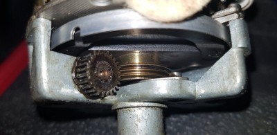

Fitted a second new Speedo cable but this time only finger tight. Drove around the block up to 25 mph, Speedo worked fine.
In the garage I checked the cable was not looping and all ok.
Today reversing out the garage I heard some odd clunking noise, drove forward and then parked up. The cable had looped and the inner cable had snapped again, this time at the entry into the gearbox. Is the problem more likely to be the Speedo jamming than a problem with the gearbox drive? If it’s the gearbox drive is it a case of removing it along with the engine ? Not looking forward to it if it is.

Re: Speedo cable breaking.
Posted on June 3rd ...my birthday.When you fit the next cable, check free movement of the cable, first when fitting to one end, then take off and then check the other end
As per telcon tonight...I think the problem is a locked gearbox in the speedo as per picture. This can be caused by wear and tightening the cable boss up too tight.
Speedo back in and working, also the clock. Repaired by Speedycables
Speedycables repaired the speedo and electric clock
