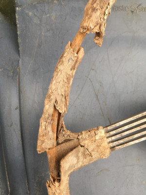

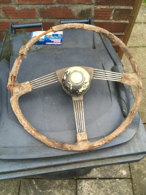

Re: Is this a Javelin steering wheel?
Thanks Keith. Alas the gentleman who ran ‘Wheelwrights’ in Morecambe has passed away however I have had good reports about a Kent based firm called steering wheel restorations. I could try and DIY but the rim is very badly cracked with pieces missing.
- Posts: 18
- Joined: Mon Oct 12, 2020 1:23 pm
- Your interest in the forum: I have just bought a Javelin and joined the JCC
- Given Name: Jonathan
I pulled my wheel out to examine, it’s definitely beyond a DIY repair and would need recasting.
If anyone has a better wheel I would be interested (I don’t mind if its cracked and needs some love but not totally destroyed like mine!)
JCS or another member should have a better wheel, but take off all the resin, clean up the metal and see what condition it is in. If not too bad then consider refurb.
A mold can be made from a good wheel, the molding can be tidied up and painted. Some have even reproduced the marble effect of some originals.
John Morgan from the shop turns your wheel into a wooden-rimmed wheel.
Keith's suggestion is good, for smaller cracks JBWeld Steelstik is recommended, I suspect an epoxy liquid would be the
way to go with making the entire rim via a mold. Yours is certainly saveable.
A good "as new" wheel is expensive.
