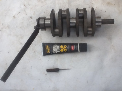

Picture of grease and turning bar and my little scraper made from a small 3 cornered file.
