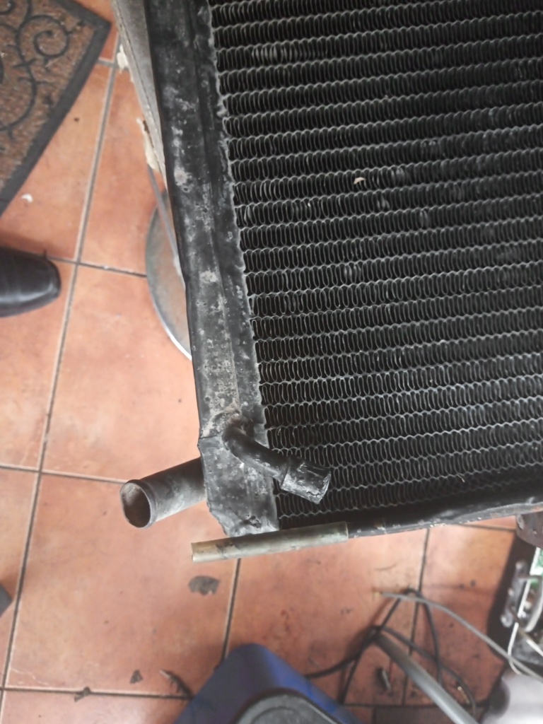

Re: Jupiter restorations.
What is the pipe in the picture of my radiator?
Heater connection? Was there a common reason this was blanked off?
Yep, heater port. TR2 and early TR3 heaters will work. Land Rover Mk1 or 2 might be the same part.
