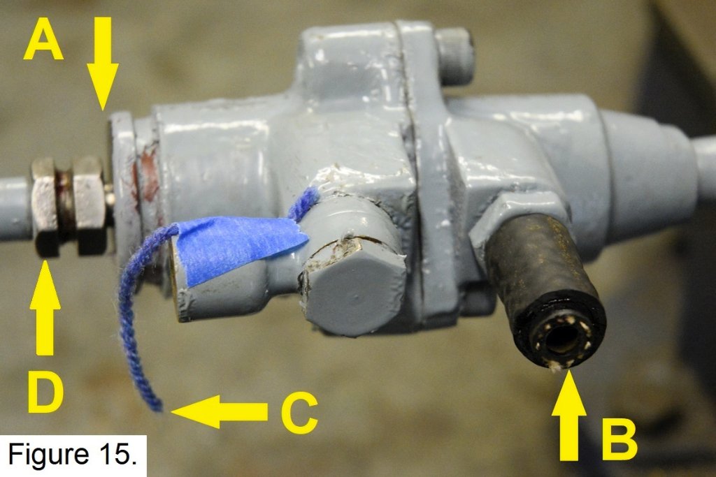

I have used compressed air to verify the position where the recuperating seal closes off the two drilled holes in the plunger.I used the pressure control on my compressor backed off until the gauge needle was just off its stop peg, A rubber hose was pushed onto the inlet port on the rear body and a piece of wool (three-ply) taped onto the outlet port fitting, hanging over the open port. Just a breath of air was blown into the inlet, with the plunger in the home position. With one spacer washer on the piston and 0.125-in. gap between the plunger locknut and the front face of the front body, the plunger rod was pulled 0.09375-in. to block off the air flow - the start of brake fluid compression, in theory. With the washer removed, the plunger travel increased to close to a 0.25-in. before the air flow was stopped - indicating longer pedal travel prior to compressing fluid.
As far as I can establish, all parts are in correct positions in the master cylinder assembly, which means that there being no gap at the locknut is rather baffling. A photo of the set up should appear here:
A = Gap, B = Air Inlet, C = Thread of Wool, D = 0.125-in. Gap.

That is strange, the bore is deeper than that in my rear housing to the tune of 0.085-in. which would increase pedal travel before compression of the fluid commences.
I have a complete second-hand master cylinder on its way to me. As soon as it arrives, comparisons will be made.

Re: Jupiter Full Hydraulic Braking System
Sorry, D should be Locknut! My mistake again.
