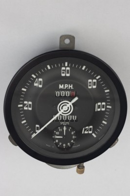

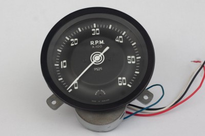

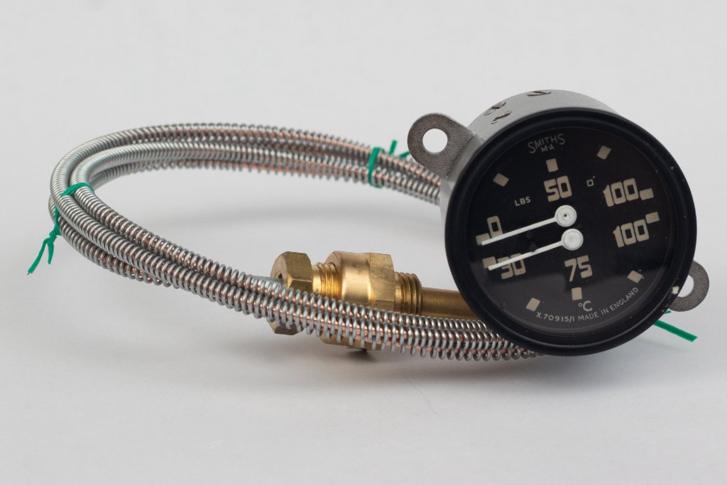

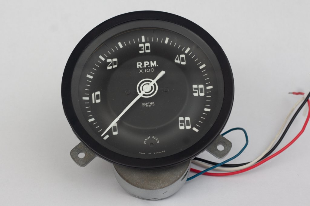

For those people not sure, these are the same gauges after a rebuild.
Re: Jupiter restorations.
David, Did you restore? If not, then please reference company in the Services section of JT

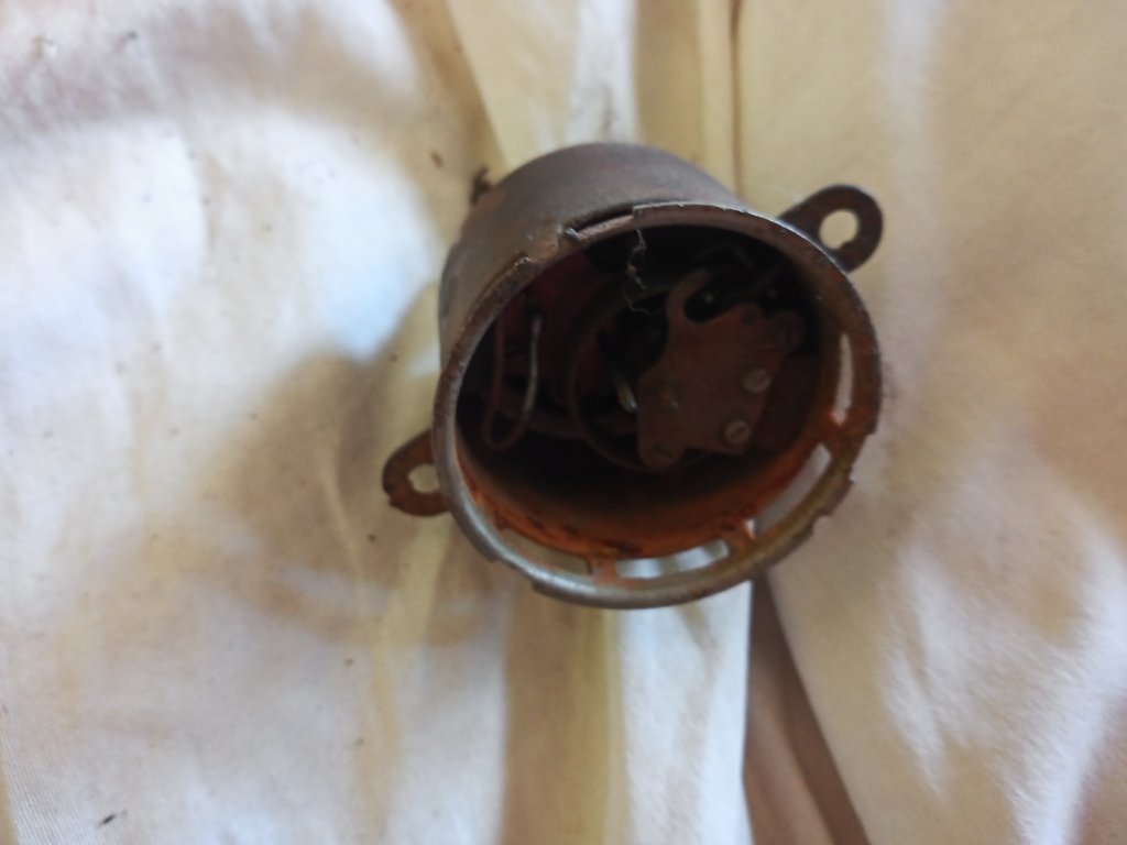

I did not restore them. A company called Liknel Otto instruments did. The only real struggle was the clock, as it was an absolute pile of rust

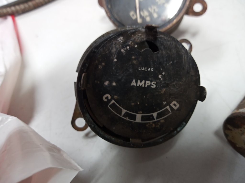

Is it normal for jupiter amp meters to have discharge on the right& charging on the left of the gauge face? Seems odd & counter to every other gauge I have seen.
- Posts: 124
- Joined: Fri Jan 16, 2015 3:11 pm
- Your interest in the forum: Jupiter Owner
- Given Name: John
Hi David -you are right, it is odd. I don't believe it is the correct gauge for a Jupiter. It should read the other way and have square 'pips' to indicate graduations on the scale, very much like the fuel gauge etc. If you do a Google image search on 'Jowett Jupiter Dashboard' you will see what I mean.
