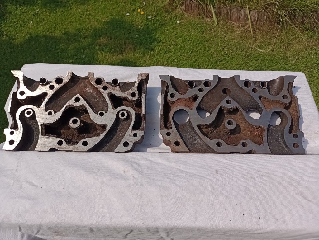

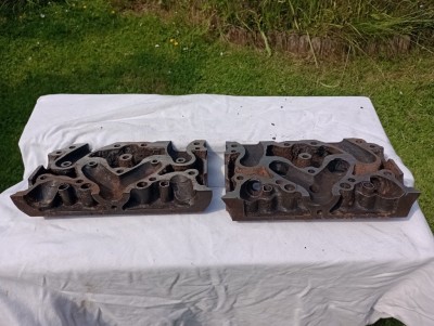

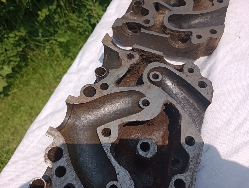

As it would happen I've just cut a cylinder head in half to have a look. Not much room in there but there are some obvious gains to be had. The rear of the inlet valve seat is very compromised and if you follow the work of David Vizard (love or hate him) a massive restriction. I'm going to do a write up and post it on here once I've got some more detailed measurements but once you cut one in half the problem is obvious. I'm going to try and split the ports at the same time, McAuley the Elder thinks it's a mad idea, he's probably right.

Americans call this "bowl hogging" and it's quite common on cast iron heads from the 50's and 60's.
I've got a few jobs to do first but when I get round to cutting this 'test' head I'll post some updates. I might be able to get it on a flow bench but I'll have to stick the two halves back together.

If it is of interest, I have pictures of a sectioned head which is remarkably similar to the one shown by Richard. It would seem that the cores didn't move too much, which is reassuring.

Anyone fancy a Twin Port Jupiter head? I've been playing with the one I cut in half to see if it was possible, the answer is yes!
Two slightly overlapped 30mm bores just clear the water jacket and pushrod tubes, it isn't pretty but this was half a day in the workshop with a hole saw, grinder and pillar drill. As a proof of concept it works quite well. I did pinch the idea from Colin Chapman and his early Ford engines.
Rich
