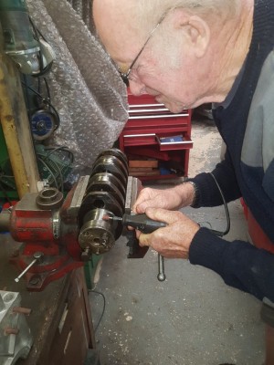

Cleaning up the oil feed hole on the crankshaft

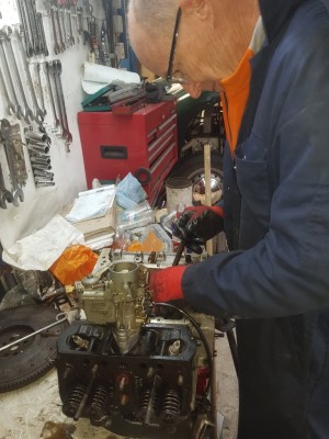

The Leopold engine with my Dellorto carbs attached via a pair of adaptor plates I manufactured.

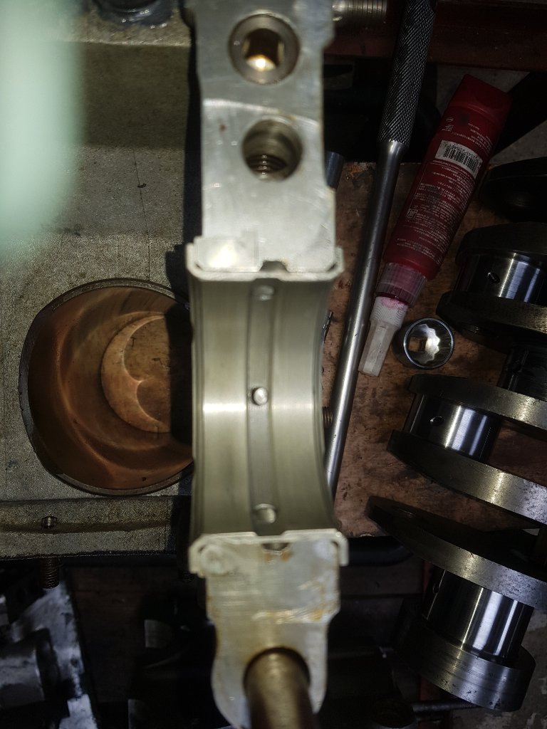

The oil had run very hot on the M62 and was black and this main bearing suffered.

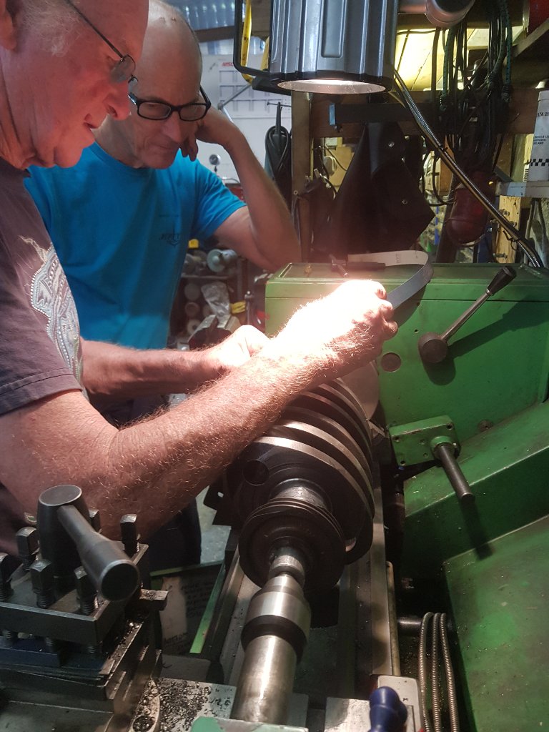

The crank out of the Smailes engine required some fettling as one bearing surface was not quite parallel through poor machining.
Extensive fitting and measuring gap with Plastigauge eventually got a rotating crank.

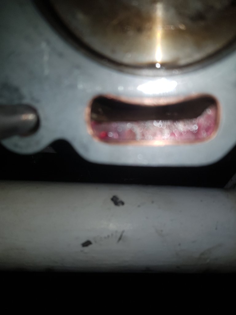

The previous and following pictures show when we noticed the lowered centre line of the block as the head gasket was not in its usual place.

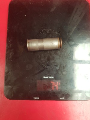

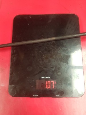

The original Jowett push rod was much heavier than the new pushrods manufactured to Scotts specification in USA.
Scott had brought over push rods manufacture to his specifications but we had made a mistake in estimating the length. They were too long as the lift on the new Piper cam is so large. This is the first modification.
