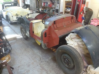

I’ll start where I left off last time. The rear clamshell was test fitted to make sure everything aligned. I didn’t have much to work with so it was a case of measuring the distance to the chassis rails and making sure the centreline agreed with the bulkhead position. With a bit of effort it was as close as it was ever going to be.

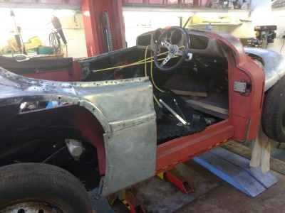

The next task was to start on the A pillars at the bottom of the scuttle where they always dissolve, I had already cut them back and given the steel a coat of DEOX to give me something to work to. I don’t know where these replacement parts came from, or I can’t remember, they were in a box of bits in the garage. They might have been an old batch of JCS ones, either way they don’t fit. They are a different width and the folded seam where the door closes is in the wrong place in relation to the outer panel. I think Chris had a similar problem with one of his restorations and made a new set from scratch, in hindsight I should have done the same but I didn’t. I did manage to make then fit in the end but it would have been much easier to scrap them and start again. The seam still doesn’t line up properly but it’s not visible with the door closed.
I had to cut the front section out to reduce the depth do this needs welding back in, the front of the sill is bolted in place while I weld everything up. This worked quite well so I left the bolts in for now. The side panel of the scuttle had been repaired in the past and the metal was in good solid condition, the weld was a bit messy but solid so I left that alone.

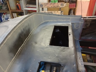

The rear shelf and back panel were test fitted. These were in a very bad state as they had been folded up before storage, it wasn’t me as they arrived like that many years ago. During the build I have tried to keep every panel original if possible, everything is stamped with the body number 60 and is correct for the car and I wanted to keep it that way. After much bending and hammering I decided these panels were just about serviceable, just! They need patching up in a few places and they won’t win a concourse but they are the ones fitted when it left the factory.

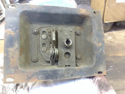

Boot lock was stripped and restored.

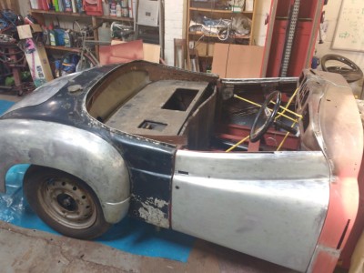

Bonnet and front wings stripped of old paint and test fitted, things are starting to line up now I’ve made a new steel support for the rear edge where it meets the scuttle.

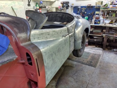

Eventually we get all the body fitted and most of the paint removed. I don’t know what Jowett painted these things with but it sticks very well.

The rear shelf was fixed in place and patched up as best as possible then seam sealed, I’ve deleted the opening where the hood went and plated over this to seal the inner wheel arch. Nothing that isn’t reversible should I change my mind one day.
