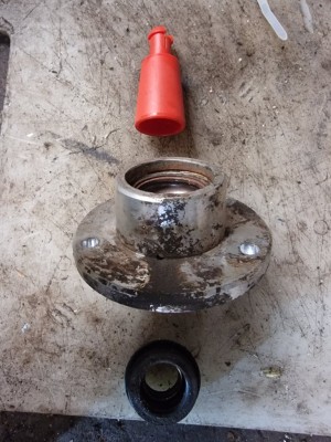

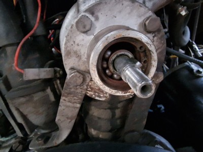

A noise from the front of the SA was found to be a collapsed water pump bearing. Drummond told me the number of the one he had used so this webpage showed three possibilities.
I chose the GJN high temp as a replacement.
Getting the old one out was a challenge. A knife and a couple of screwdrivers separated the housing.
Then the water seal was carefully pushed out with a plastic drift from my sawbench. Then I made up another drift from an old exhaust valve on the lathe to push the remains of the bearing out.
