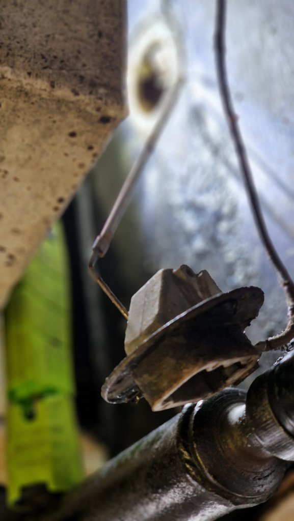

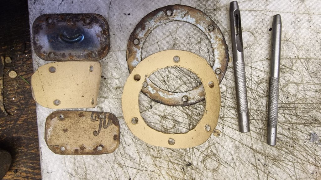

I also noticed a leak around the petrol sender, so this has been out today and the gaskets replaced. Much easier to do on the SC than the Jav or SA!
