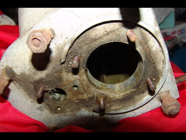

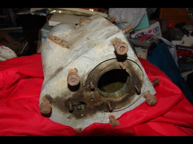

I notice that the mystery box has a casting number on the side - does this shed any light with anyone?
I still reckon that this was a prototype box maybe for a stillborn 8/10 hp upgrade, or even as part of the Bradford development. Maybe it was too expensive and the production vehicles got the cost down version. Alternatively was it an export variant designed to circumvent some taxation or patent problem that was eventually resolved?
And thinking far outside the box - what about the La Roche?

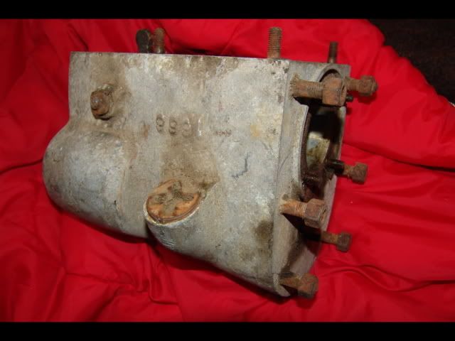

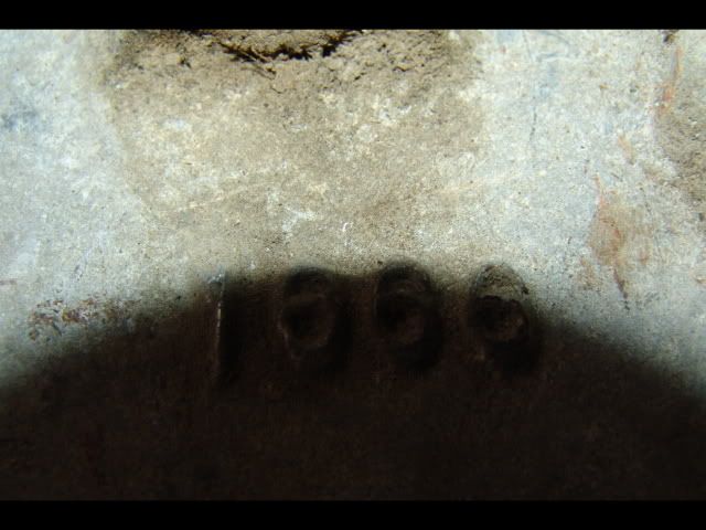

The pic is sort of hard to see what the number is? Cant check casing since dad has misplaced the gbox housing.
What i think it is 9991? or maybe 8991 its a bit hard to see when you zoom in on the pic.

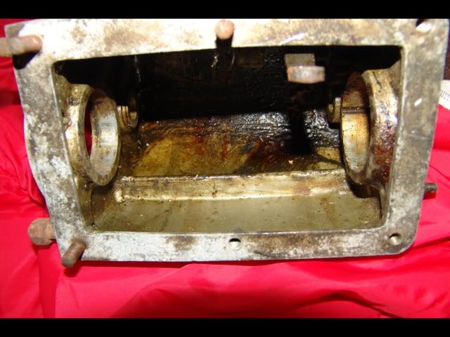

Dad Just dug the Gbox housing out...
The number is up side down so is number 1666.
Here are some more pics of it...
