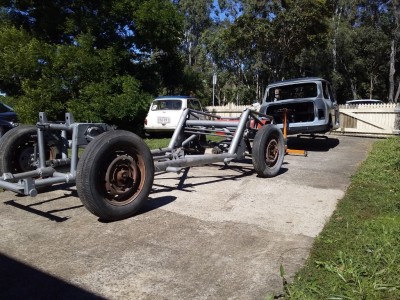

My baby is back on four wheels, with new bearings & bush's she rolls beautifully.
I have temporally put the body back on to concentrate on the engine. Though I hope to have a colour test shortly.

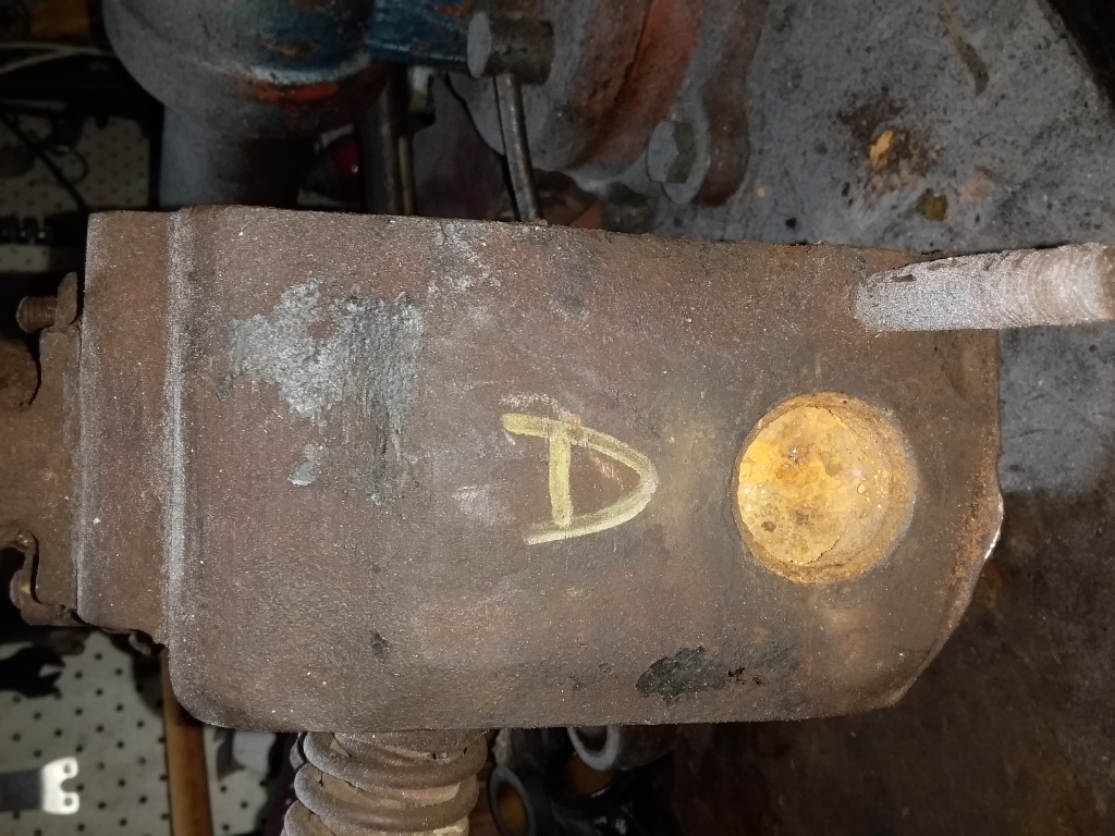

This is one of the odd heads I have, note the lack of frost/welch/core plugs.
What is it ? A PA?
What is it ? A PA?
