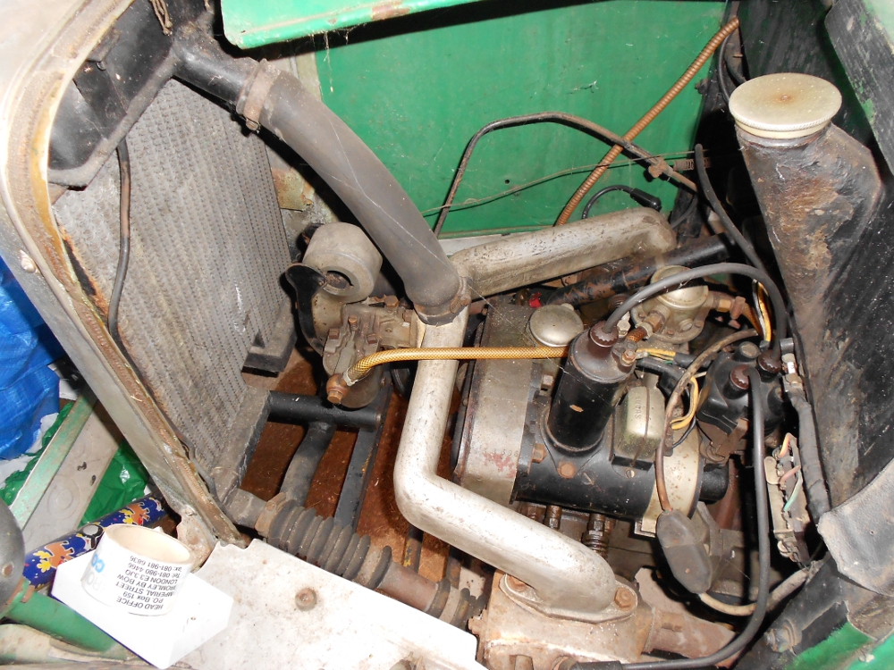

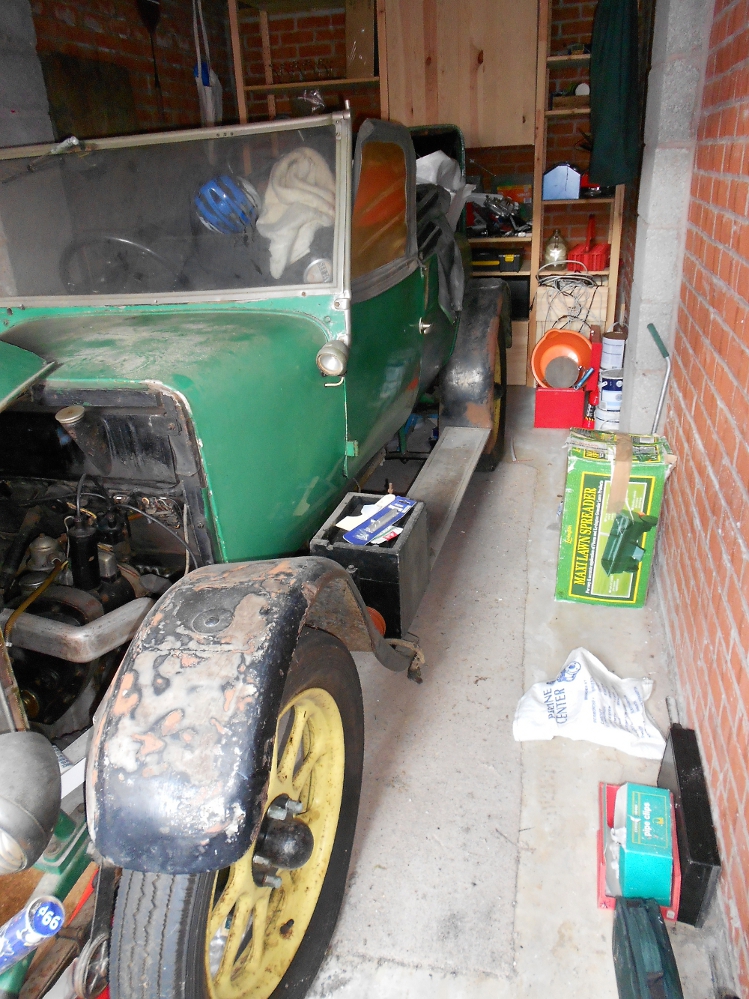

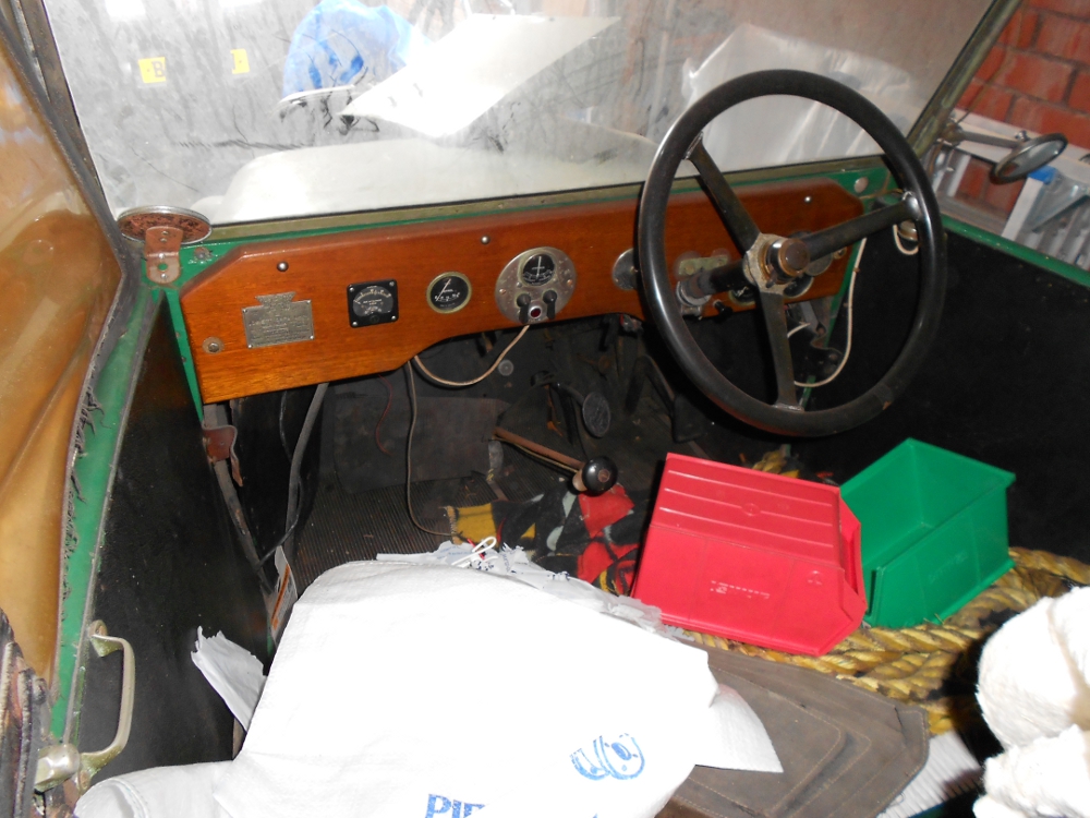

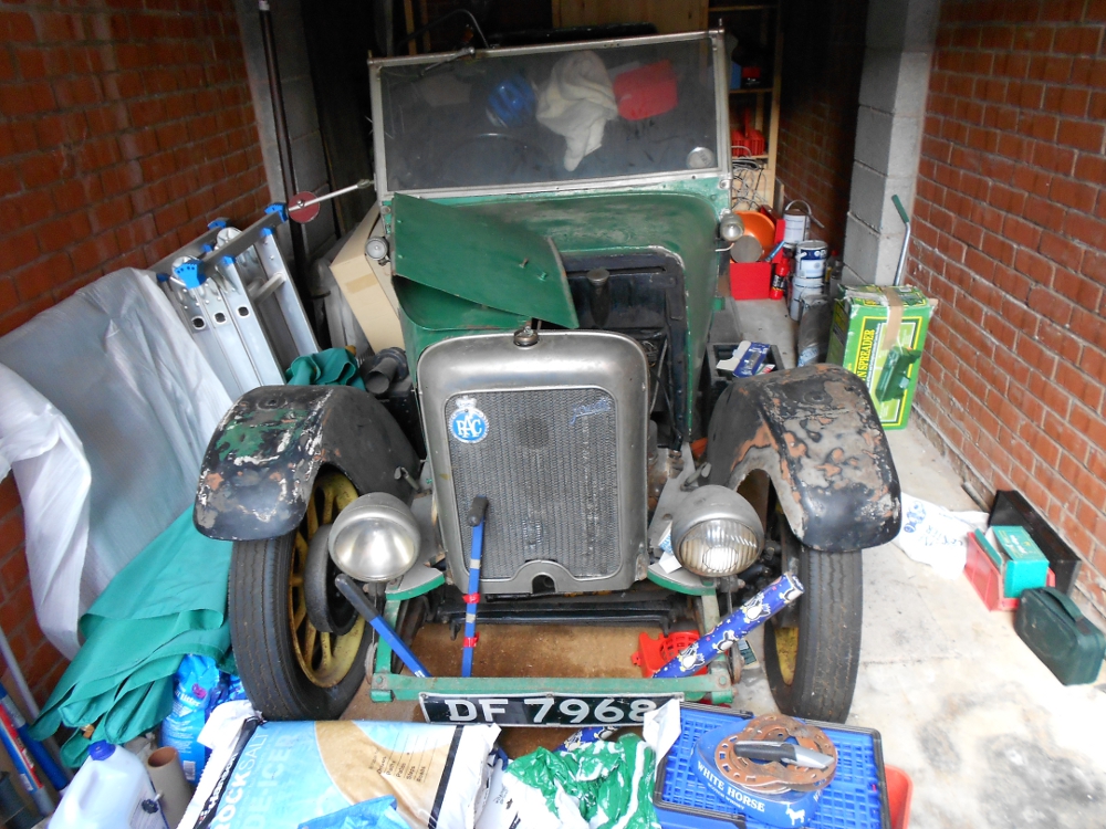

Another couple of pictures. Had a few problems getting round it I'm afraid.
Re: Possible Jowett purchase
Hi Barry - nice to see some photos of teh car. Particularly as its been in the family from new it would be a shame to 'restore it as it looks very complete. Perhaps some gentle conservation to its condition when last in use would be more appropriate as ori;ginal more or less unmolested cars don't come up that often. For what its worth it looks to have a 1934/5 engine & 4 speed box (33 had fixed starting hanadle, yours looks as if it hasn't. Also carb and pupmp look late 34/35/ish to me. If it was me I'd keep this engine & box as they have presumably 'belonged' to the car for something like 50 years and so form part of its history - but others may disagree on this point/

Thanks for your comments. I'd agree. If it was a wreck pulled out of a hedge, then restoring it to pristine original condition would be more appropriate, but in this case, I think it would be a shame to end up with a museum piece I was scared to get wet or let kids climb over it to get to the dicky seat. My other interest is classic bikes ( i have owned a Moto Guzzi for 20 odd years) and it breaks my heart to see bikes being pushed out of vans and straight into the marquee. It seems to have become a source of pride with some collectors to have bikes without number plates on to show just how serious they are about not even starting them!
Interesting you should think it had a later engine. It did look different to all the photos of 1920 ones I had looked at. If it has been changed, it was probably well before 1950. As you say, it's part of it's history and I wouldn't be looking to wind the clock back as it were. Does the catch on the gear lever make it look like a 4 speed? I'm guessing it is the gate for reverse? It also looks like it has been converted to 12 volts at some stage. It has battery fitted each side. The last chap who used it owned an electrical engineering firm, so it wouldn't be much of a surprise.

Not much to add to the comments from George and others, but I agree it looks a bit different under the bonnet from my 1930 Long Four (as you'd expect!). It looks as if you will easily beat me to an 'on the road' status.
I am pleased to 'hear' you think it a good idea to get the kids involved, couldn't agree more. When they did the WAIT,AND, SEE expedition across Australia they made a point of stopping at schools and Care Homes on the way and the responses were astonishing! (and mostly good!).
Check the serial number on the engine itself. It should be stamped on the top of the crankcase near the oil filler cap. The first digit gives the year date. If original it will be the same as the chassis number. Also note somewhere near there a couple of letters stamped in. These are the initials of the man who set up your engine before it left the factory. Tony Fearn posted details of these a couple of years back.

I have the logbook now and the engine / chassis numbers don't match. The engine number is 436395, so from what you say it is 1934? Chassis number is 925663 if that means anything. In the box of paperwork I brought back are a couple of 1934/5 manuals along with the original, which makes sense now if it has a later engine. Thanks for the advise, as it could have been a bit frustrating to think I was working on a different engine!

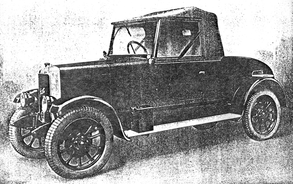

Hello again Barry and welcome to The Club. You won't regret joining us!
Thanks for the photos, it seems you have a wonderful mish-mash of bits and pieces on the car as George has alluded to. It's obvious that the majority of the later additions were made to keep the old girl going with whatever came to hand, and it would have needed ingenious mind to mix them all together to achieve this.
Early pre-war bits are slightly more common than the vintage ones, and at the moment are not as expensive as the latter, although they are also becoming rarer as the years pass.

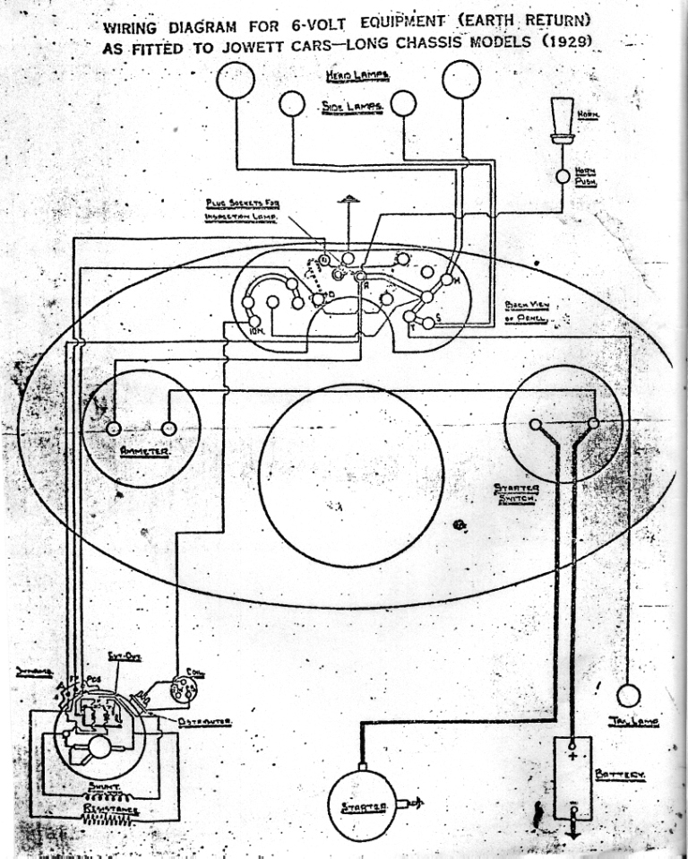

One thought I had, when viewing the photos you posted, was that the flanges on the aluminium induction pipe look very thin, so take great care if you are removing and expect to replace it on the engine. (see the post in the pre-war section on 7hp cylinder heads)
I've attached three scans of photocopies of photocopies that I think are of a 1929 long-two with dickey. I notice that the colour scheme is different to George's post, so I'll stand to be corrected if it isn't 1929.
The wiring diagram is what would be expected for a long chassis 1929 Jowett, but don't take too much notice, it's only there for posterity.
P.S. Note the position of the door handles, they don't seem to be of the 'suicide dooor' type.

the chassis number beginning with 9 denotes it as 1929 and the engine number is 1934 model year although it could have been mde \\7 registered in the latter hapf of 1933, model years running from the previous years Olympia motor show.
