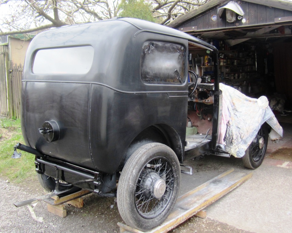

I've managed to spray three coats of the black cellulose over the primer now, and have flatted it back with 1200 and then 1500 grade wet and dry paper.
Just have to wait for more nice weather to spray the final coats.

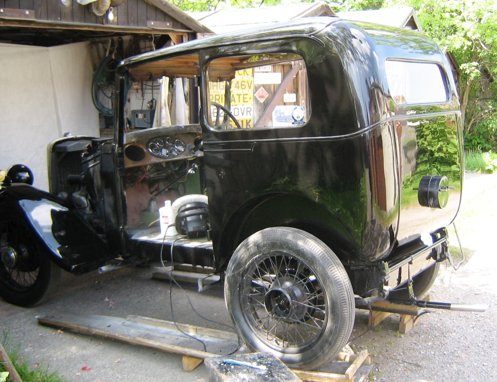

It's Saturday the 8th June 2013 and I've just finished painting and polishing 'Mary Ellen', so I attach a similar photo to one below which shows the not-inconsiderable amount of elbow grease that's been expounded.
There's still everything to put back together, and perhaps new carpets, but I hope to come in her to the Ex-Employees' do and the Commemorative Run the day after, (both in Bradford), on 10/11 August.

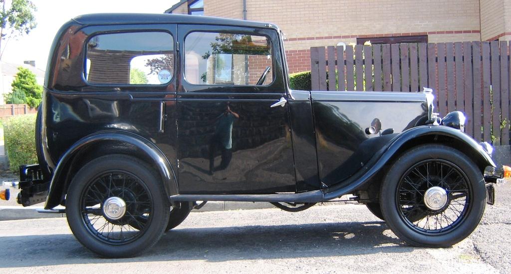

I've found a sign-writer, he hasn't come yet, but I thought I'd just post a photo of 'Mary Ellen' looking all shiny.

Well, Richard Phillips of 'Top Signs Plus' came over from Burnley (8 miles away) last Friday (23/08 2013), and lined the car with green enamel, and painted 'Mary Ellen' on both sides of the bonnet in an ivory/cream colour, so she's now complete. Richard would have come over to do the lining before I went on the Boroughbridge Commemoration Run, but he'd not taken my telephone number down correctly. He had ********100, whereas the last 3 numbers should have been 010.I wrote:I'm hoping to find an 'old-fashioned' sign writer who can use his squirrel hair brushes to put the green waist line on, and re-write 'Mary Ellen' on the bonnet as I discussed with Alastair on JowettTalk many months ago.
It was illuminating to watch a 70 year old chap (only 1 year older than me!!) paint the green line around the car with only a few long hairs tied together as a brush, and with a steady hand paint a perfect line.
The difference that simple line makes is amazing. It lifts the whole car, even though it isn't 'in your face'.
Not everyone is enamoured with the 'Mary Ellen' on the bonnet, but it's been on the car since about 1963, and I like it. Members don't have to remember the registration number (BV3232) when talking about the car, and most of them will know which car the other person is talking about. It also creates interest when out in public, with many kids reading it and commenting on it to their parents.
