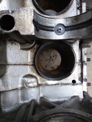

Thanks to Keith's help, I think I might have managed to post the photo of the internal damage to a spare crankcase, caused by the Big End bolt head?
Or maybe not?
For backup, I plan to send the photo to Keith, so perhaps he can insert it? The scuffing can be seen just below the liner.

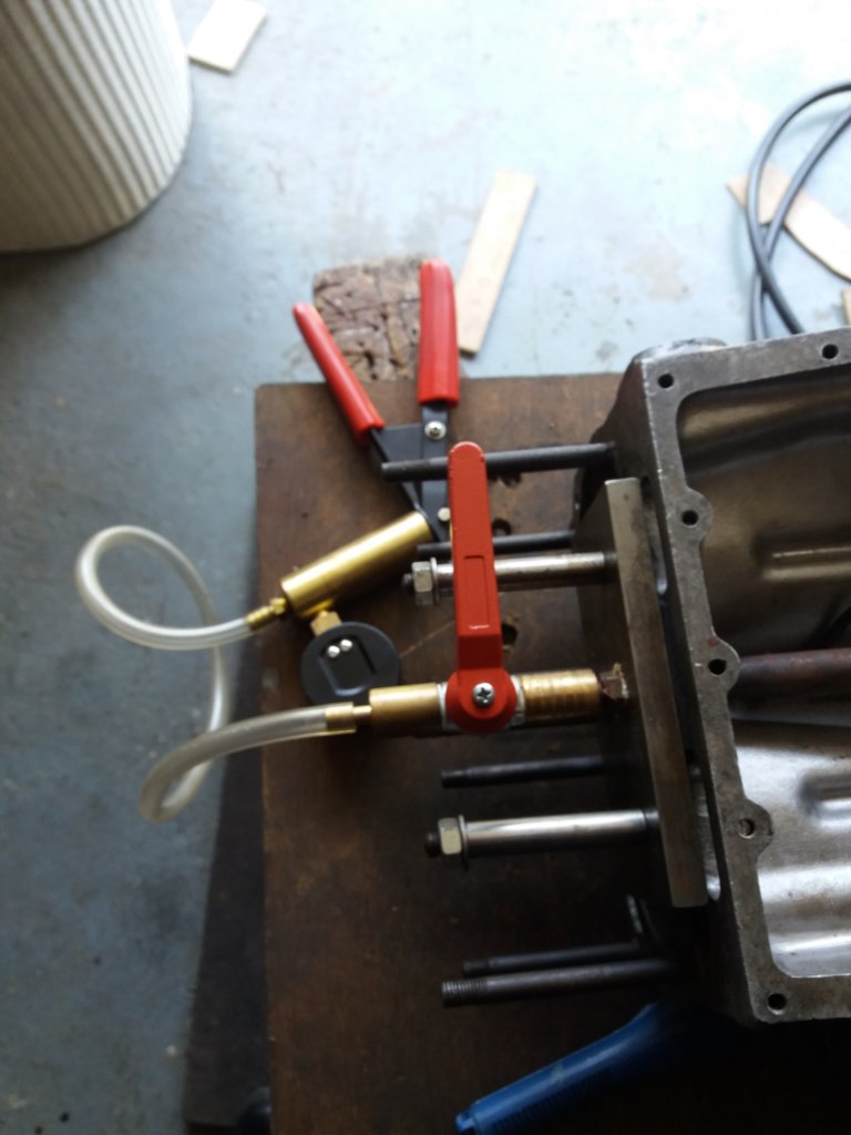

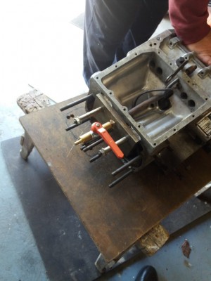

Completely chuffed by this success, I have also attached the photos of John Airey's balance pipe test rig, which was great to use at his Swindon Workshop!

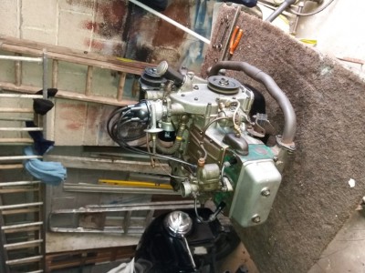

Anyway, we managed it and I have attached ( hopefully? ) a couple of photos. I had to pack up then, but I know Vic will enjoy making the various pipe connections and filling her with oil. Next time, we should be pressing that starter button! Wow!
