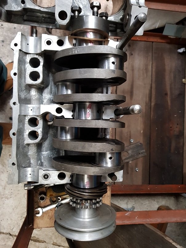

Thanks Philip.
The three to five bearing difference is significant as there is more unsupported mass and strain on the webs from the piston stroke.
Yes there is more space for the web in the Jowett but its thickness is huge in comparison.

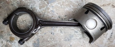

Some more pics as I am in discussion with Basset Balancing.

Those are both great inputs into the discussion and make me wonder where the Jowett engine would have gone with the same amount of development.
I think there is a danger in copying a modern crank web design based on looks without understanding the relevant differences in the Jowett set up.
The pdf article shows how so many aspects of the design are inter-related. I would only start trying to copy a three bearing crank design and ignore any 5 bearing one. I would also err on the side of caution because of the known flexibility of the block as this must put greater strain on the crankshaft.
But counter to that is that a lighter crank might reduce such stress. I say 'might' because a much deeper analysis is required. Maybe the weight makes no difference to strains if the crankshaft is balanced and the metal is taken off in the right places where it is not stressed.
You can see some knife edging (or at least change from the flat web) in the Laystall Jowett crank. You can see some interesting shapes on the Lancia where the webs are asymettric. But this would be a massive change to the existing crank!
What I think this shows is that the dynamic balance is achieved by mass applied by opposite imbalance at each end of half the crank. This should balance out the unsupported weight of the web in the middle. The unsupported web also looks to be much thicker than those next to the main bearings suggesting it requires much more strength to withstand the twisting forces between the two big ends.
If only I had access to a CAD system.......my 1960's engineering training and aged brain cannot do all the calculations.
In the attempt to reduce the offset in the plane of the pistons, the cylinders can be located on opposite sides of the crankshaft, as in the Jowett "flat twin", and use a two-throw crank so that the pistons move in opposite phase. It is not usually desirable in practice to place the two cylinders in exactly the same plane, so that there is usually a slight couple as shown but it is much less than in the side-by-side arrangement, and balance, on the whole, is fairly satisfactory. The orthodox four-in-line engine can be quite well balanced if the cranks are arranged in pairs at 180 deg., each pair being opposed to the other to cancel out the individual couples, as shown. This arrangement is sometimes termed " mirror" balance, as each half of the engine resembles a reflection of the other as seen in a mirror. If the pistons and other working parts of such an engine are of uniform mass, the engine is capable of working smoothly, and with very little vibration.
It should, however, be noted that the stiffness of the crankshaft, and of the engine structure generally, has an important bearing on the success of such engines, 'as the cancelling of the two opposed couples has a tendency to bend the crankshaft in the middle.
There are, however, other forces of the second, third and further orders where a connecting-rod of limited length is used to link reciprocating and revolving parts! This is where the art of balancing takes over.

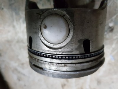

Piston picture: Those are cast or hypereutectic (squeeze cast not forged). That is sub-optimal for a racing motor.
Also, the rings appear tall, but it is a little hard to judge from the pictures. Thinner rings are less friction. Top ring can be as thin as 1.15mm and 2nd around 1.5mm. The oil ring would be around 3mm. Gapless style rings can be used in either 1st or 2nd to lessen blow by.
