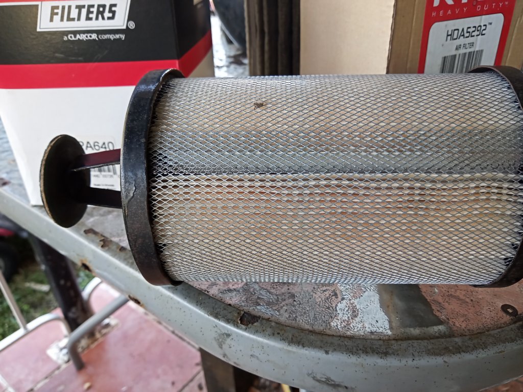

I found these filters almost fit a Bradford . the narrow one is slightly too tall.
The wide one fits nice however it does not fit with the housing on.

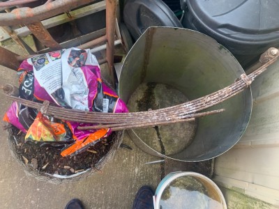

My Bradfords original papers give it a carrying capacity of 10 cwt.
There has been an ongoing discussion between Bradford owners of the difference between 8cwt & 10cwt cars.
The parts catalouge lists springs based on cwt but not what is different.
My car has 7 leaves on the back & 5 on the front.
As they have been rebuilt in the past is does not mean it still a 10cwt .
Can people please count their cars leaves to solve the mystery. My quess is the passenger cars would have a softer ride.

Re: I should know better at my age
I don't know the answer to this, but on other cars the spring rate is not just dependent on the number of leaves but their thickness and the curve set on the spring. When I needed new front springs for my Bradford I went to Jones Springs (https://www.jones-springs.co.uk/vintage-car-springs) who have all the specifications for Jowett Bradford springs and they would be able to give you the full details I'm sure - perhaps try sending them an email with the question.
Hi David,
I've attached a scribble that I used to take with me to the National autojumble at Beaulieu when I was looking for bits to make my 'Flying Fox'.
Of course this is for the pre-war Jowett 7hp cars.
If I remember correctly the Bradford leaves were thicker than the 1/8" of the passenger cars, and the peg bolt was not central.
The 10cwt spring has 7 leaves and the locating pin is central as per the image, this one came off a CC van and I can be fairly certain that it was original, My CB has the same layout of spring and was also rated at 10 cwtDavid Kemp wrote: ↑Fri Apr 21, 2023 11:10 pm My Bradfords original papers give it a carrying capacity of 10 cwt.
Thanks for that, I contacted Jones Springs who were extremely helpful. They gave me the data for Jowetts going back to 1928, but could not find Bradford springs. From what I can deduce it is only the back springs that vary on a Bradford. Hopefully someone will have an 8cwt Bradford who can count the leaves.
