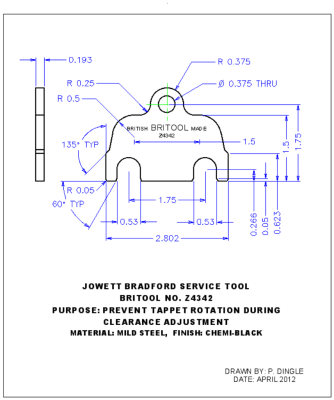

Does anyone have the dimensions of the Bradford tappet spanner? This is the one that holds the two tappet & looks like a fork.
I could measure my tappets , however i am not a contortionists & was born lazy.
Re: I should know better at my age
David, I think that you are referencing this tool? I have one and got the dimensions from it.
Thank you. That is the one I meant.
