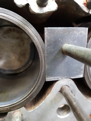

Top of the piston liners have a ridge with a valley either side. How is that going to seal? Perhaps it might give more bite.

What have we here?
It looks like a cylinder liner from an engine with Siamese cylinder bores for compactness. Probably requires a particular head gasket type?

The flat-sided liner does look like it was intended for a totally different engine perhaps with a Siamesed bore, however the ridge on the top face is fairly common with MLS gaskets which would be hard to seal without that feature.
ridged liners
I have not taken them out so do not know how they are sealed at the bottom.

Agree with all the opinions on the possible origins of the liners.

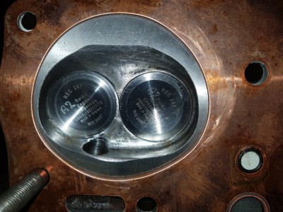

What head gasket type leads me to ask who built this motor and when? Were MLS gaskets around last time this motor ran? I am assuming the head gaskets were gone when the parts were delivered to Keith.
If the grooves don't foul the fire ring, I would guess they might aid in sealing: less area means more pressure per unit of area. Perhaps the grooves allow the gasket to squish into the groove?
JT has a discussion about MLS head gaskets in the last year or so. viewtopic.php?p=44727&hilit=mls+head+ga ... tic#p44727
Will the CR be above 12:1?
Would a solid copper gasket seal better than the composite one?
Are you going to pull the liners? Seems risky not to do so, but who knows what lurks at the bottom?

Harry revealed that they are allegedly Wills ringed. I need to read up on this as I have no experience. The gap between head and block when torqued to 20 lb.ft is between 25 and 30 thou.
That is high but will have to check height of ridge on liner. We have standard gaskers, but could fit NZ but I also have some solid aluminium ones.

Must admit my first thought about the first photo of the cylinder liner was Wills rings, but then I thought you were familiar with such cylinder liners. The second photo has about convinced me, but I am not at all sure that MLS gaskets would work in a setup like the Jowett engine - dissimilar metals involved, along with possible small variations in liner protrusions, if any.
I have only read about Wills sealing rings, so cannot comment much about the entire system. I think there was an article in Jowett Jive (USA), by Ted Miller, many years ago about Jowett's use of the Wills rings system?
Both photos tell me that the liners are thin-walled and may not cope with protrusion-gasket-type-cylinder-head-tightening-torque as applied to the Jowett engine. Does that make sense? I seem to remember the first 2.5-litre BRM Formula One engine having trouble with thin-walled cylinder liners yielding, but that was most likely back in 1955.

The part that makes me wonder if they are Wills ring type is that all the descriptions I can find mention a groove for the ring and associated pictures show a single groove. These have two grooves and a raised ridge in the center. Which groove gets the ring? Why a second groove? Two rings? Why the raised center?
Rambling through endless dead ends, but found this informative:
Fire Ring: This term refers to the metal sealing ring that surrounds the bore of the piston between the engine block and cylinder head. It can be part of the gasket itself, it can be assisted, or it can be stand-alone for any given application. Assisted sealing rings are normal Fire Rings, attached to the gasket, which have supplemented sealing qualities through the addition of o-rings. Stand-alone Fire Rings are not attached to the gasket, hence the name. These are types of assisted and stand-alone sealing rings: O-Rings, Wills/Elring/Cooper Rings, Pyramid Rings, Cut Rings. Each differs slightly from the others, usually in either their engagement or their seat.
O-Rings: This term is usually used to describe any block-to-head sealing rings that sit in machined recesses. As an engineer though, I can tell you that when speaking openly about about o-rings (as opposed to speaking to people who are actively/directly involved in the project/application you're discussing/working on), it is extremely important to differentiate and be very specific about which type of o-ring you're referring to. Typically, there are two types of o-rings....solid rings and crush rings. Because the term 'o-ring' is used so casually, you will see why misunderstandings take place. O-Rings are used with gaskets, and are either assisted or stand-alone in their sealing.
Solid O-rings: Solid o-rings are exactly that...solid rings of metal/wire which sit inside of recesses in the engine block. These applications place the solid o-rings in grooves in the block, and they seal against the bottom of the fire ring of the gasket upon engine assembly (the mating of the block and head). The recessed grooves in this type of application must be cut extremely precise, as any variation in depth will affect sealing...due to the lack of give or 'crush' in the rings.
Wills Rings (a.k.a. Elrings or Cooper Rings...NOT 'Copper Rings'): These rings are stand-alone, and are crush type 'o-rings'. True Wills/Elring/Cooper rings sit inside of recesses in either the just the engine block, or both the engine block and cylinder head. Wills/Elring/Cooper Rings are actually hollow, pressurized/gas charged rings, as opposed to solid material o-rings. The crushability and expansion of these type of rings is what sets them apart. As engine temps increase, and the engine reaches operating temps, the gases inside the Wills/Elring/Cooper rings allow them to expand, providing a direct, super-solid seal between the two engine halves.
Pyramid Rings: These rings are very similar to Wills/Elring/Cooper rings, except that they are solid stand-alone rings...not crush type. These rings sit in recesses of the cylinder liners, and are used with separate gaskets. Pyramid rings have single or multi-point peaks when viewed cross-sectioned. These peaks bite or cut into the soft alloy cylinder head, creating a strong, direct seal between the two engine halves. It's important to point out that Pyramid rings share attributes with both Cut-Rings and Wills/Elring/Cooper Rings.
Cut Rings: These rings are also solid stand-alone rings...not crush type. As opposed to Pyramid rings, Cut Rings do not sit in recesses of the engine block or cylinder liners. These rings sit directly atop the deck of the block or copper spacer, which is used in some applications. The seal is created by single or multi-point peaks in the top of the rings...just like the Pyramid Rings. A direct block-to-head seal is created, allowing the desired higher combustion pressures.

The Wills Rings are installed in the liners which have 5mm thick walls with 8.5 mm wide flange to house rings which are 1.9mm wide, 87.14mm OD and 83.27mm ID (approx).
The liner protrusion is around 25 thou but worringly there is variation (perhaps 5 thou), but it is difficult to measure with the rings installed as they protrude (perhaps 5 and upto 10 thou). A ruler can be placed across the top and bottom only to get meaningful readings. The rings are quite soft and had a couple of scratches on them which I have polished out. I certainly do not want to try to remove them.
It is going to be asking a lot of the copper/asbestos?, aly gasket to seal the water in!
The requirement on surface roughness for Wills rings is stringent.I do not think they will like the undulations and softness of a standard gasket, especially as the fire ring might impinge.

Various gaskets
Whilst Scott was replying I was looking at the gaskets I have.
1. Bill Lock (copper/asbestos/aly) 78mm 2. NZ red (small) 76mm 3. NZ Yellow (large) 79 mm
No picture as it has just a bit wider hole than 1. I have taken lots of pictures showing fit on liner and on head for each gasket type. The bore is 78 mm so the small ones (2) protrude over the liner wall, but they did not leave a gap of uncovered liner top.
But this was all to no avail as the Wills will be fitted without gasket ...so now to cut out a suitable material to seal the rest which needs to fill a gap of about 25 to 30 thou. My gut feel is something that will compress about 10 % so needs to be about .9 mm thick uncompressed. Perhaps go to 1mm with 20% compression possibility at 30 lb ft. I am sure it is possible to work out the pressure at different torques in this scenario. Remeber the block is not perfectly flat.
This also raises the issue of what torque as nearly all the load is going to be on the rings and we do not want to pull the studs out of the block?
