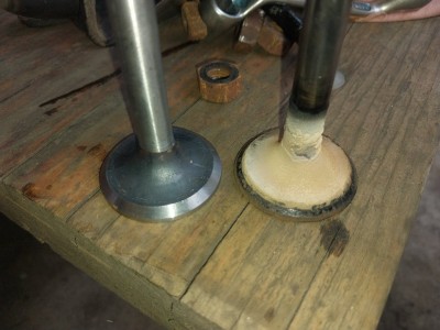

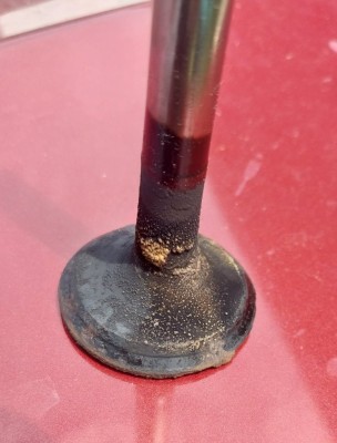

I made the valve spring compresser. It worked very well, the rusty lump of steel next to it is the scrap I started with.
Sadly as I suspected the exhaust valve on the drivers side is cactus.
Re: I should know better at my age
Oddly a valve facing machine was for sale locally cheap.
I bought it & incredably re faced the valve.

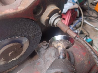

This is the easy way to lap valves, it takes 5 minutes with this air tool rather than 50 minutes by hand.
It is also easier on my old hands!
The end of both intake & exhaust valves were worn & needed grinding.

After fixing this valve on the drivers side, the other cylinder was now down on power by comparison.
So off came the head & the exhaust valve was also needing a grind. By luck a box of NOS valves was for sale on ebay.

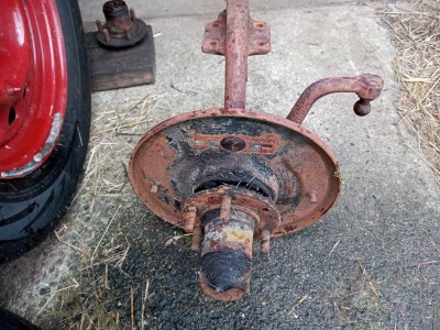

One step forward & another one back. Thats the old car tango.
The front axle eyes are oval not round. One kingpin fell out it was so loose.
Any ideas on a fix? Is the axle steel or iron?
If steel possibly I could run a bead of weld to shrink it.
All sugestions welcome.
The axle is a steel forging so is weldable.
I would consider machining the axle and bushes out to 18mm and making some new pins to suit.
I would think that it is doubtful that running a weld around the outside would shrink the bore sufficiently to work.
I tried the welding method, this worked well but not good enough. I contacted the club & they do have front axles.

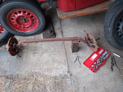

I have picked up another axle & have started cleaning it up.
It has been sitting outside for many years.
It looked very unloved compared to the other axle in storage however after measuring wear it was the best..
Which shows folks please dont dump those old rusty parts as they can still have life.
