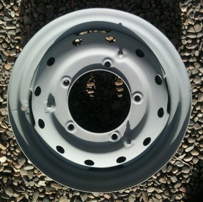

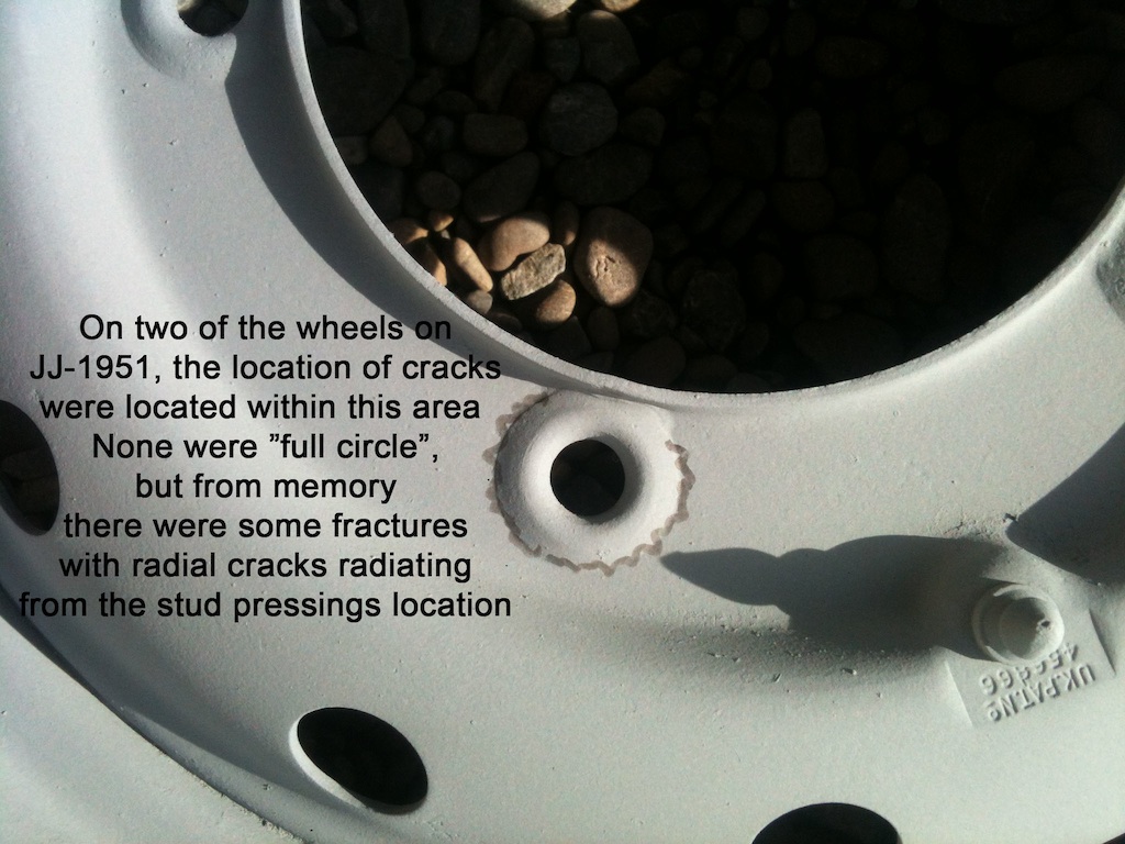

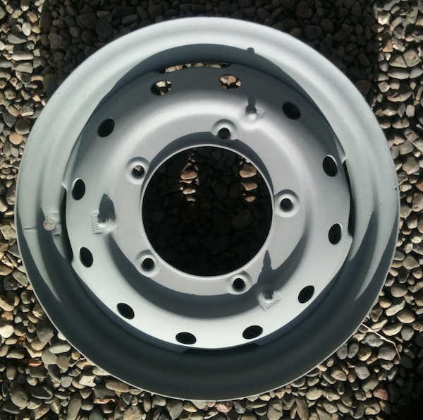

Hello all.
During the restoration of JJ-1951 all those years ago, I discovered during preparation for painting that there were cracks in a couple of the wheels. The cracks were partially around the raised wheel stud pressings where the raised metal left the flat area (as shown in the image). There were also some radial cracks from the area just described (from memory!). Those wheels were repaired by gas welding and normalised in a furnace, but were evidently "scrapped", as I can no longer find them in what was the kids playhouse and which is now a storage facility! If I could locate them I'd photograph the actual repairs . . .
Back then, I was lucky enough to buy a set of 5 brand new Jowett Javelin wheels for the princely sum of $NZ25 (about 13 UK pounds in today's UK money
) Granted, I did need to make the ring of holes to make them into Jupiter wheels
So, I write this to show that my experience seems to be different to what others are reporting. My recollections are from my memory as I can't "prove" it with images (at this time), but my advice, for what it's worth, is for owners to have any good wheels normalised BEFORE they need repairs. My bet is that they were never treated this way when manufactured . . . . and most wheels have lasted pretty well. Normalised they might last forever!
After clicking on the "Overall image", so as to enlarge it, please feel free to download the resultant image to aid in your own descriptions and comments on this subject, (right click and "save image").
Keep well.
Leo.
