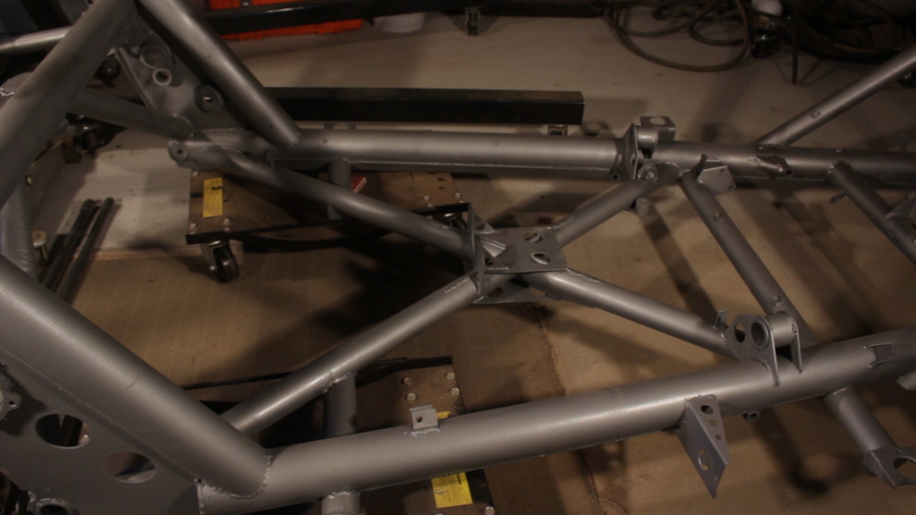

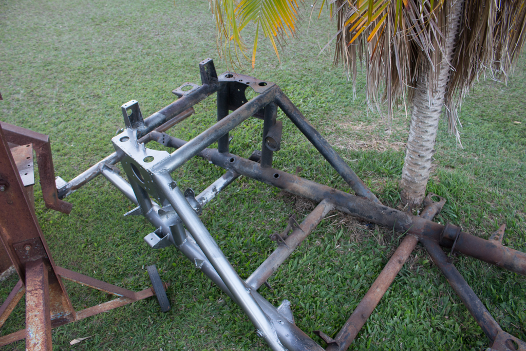

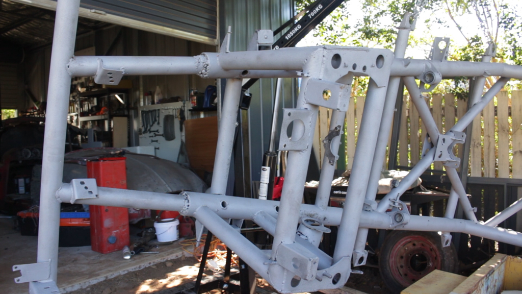

After Sandblasting

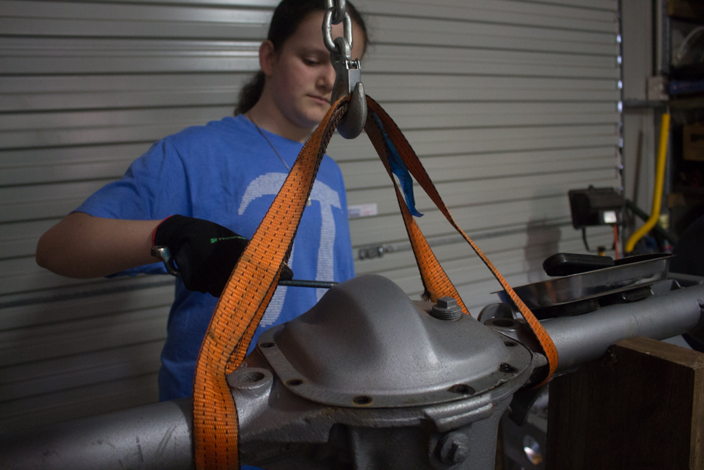

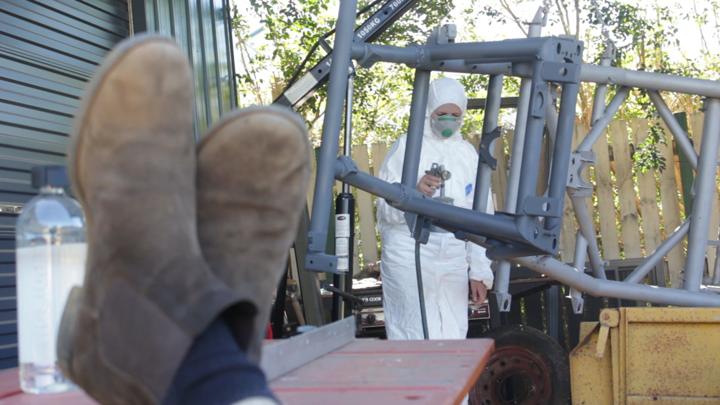

My feet up, watching my daughter painting

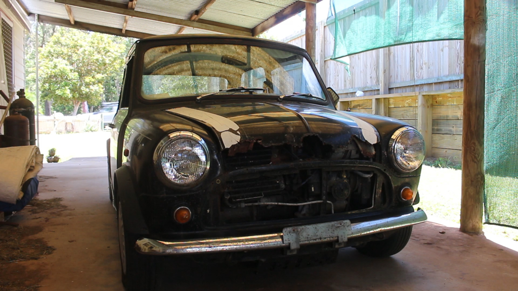

My children now have their own project, sadly not a Jowett

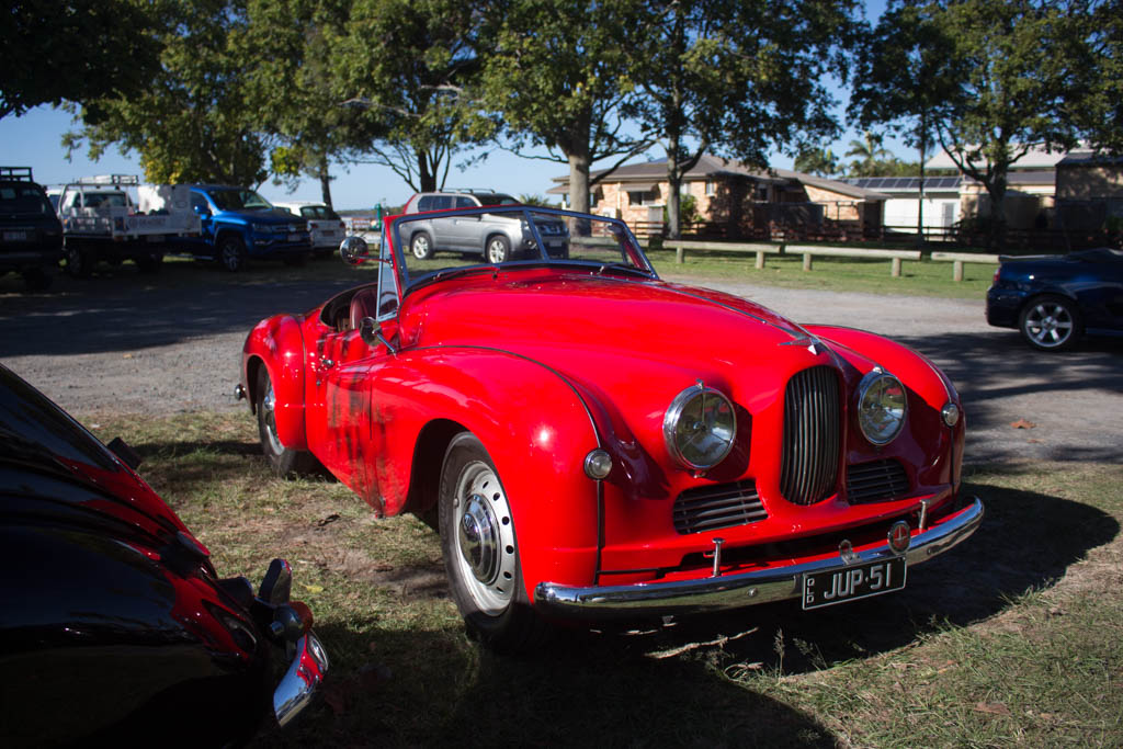

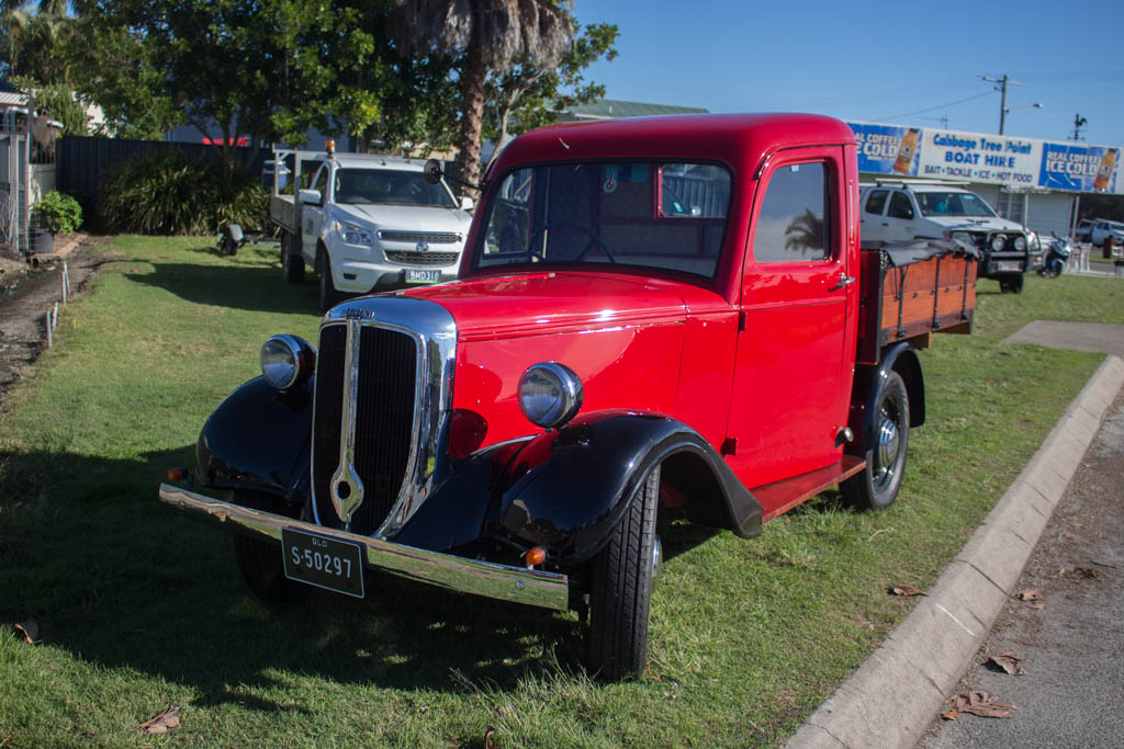

Though the middle of winter here in Queensland, The Jowett run this weekend was still well attended.
Being QLD not cold allowing the Jupiters to arrive with tops down. Here are a few attendees.
