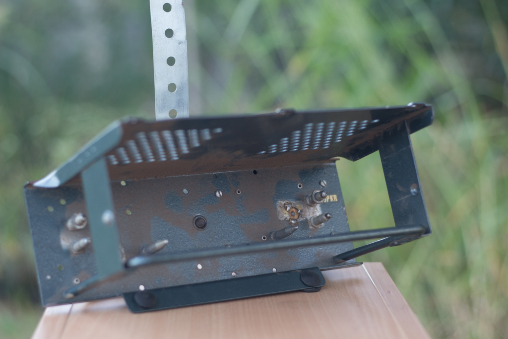

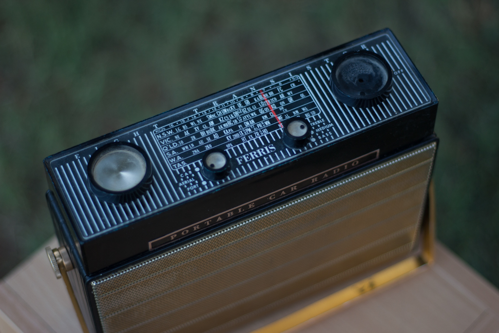

I have bought a period radio for my Jupiter, it is an Australian made Ferris which was the 1st portable radio made in
Australia if not the world.My son has replaced the old capacitors as preventative medicine, & it runs well.

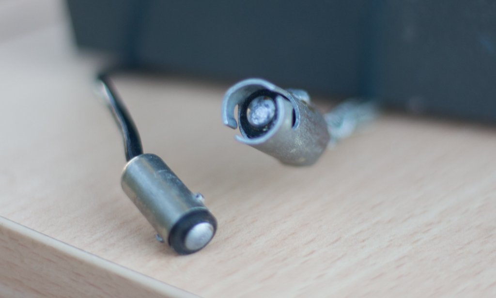

Only problem is the antenna fitting is unusual, does any one know what it is? Or is it proprietary? I realise I can change the end, but would like to leave it as is, if possible.

I would say it is a small bayonet connector with soldered wires.

Hi David, it looks like you have quite a rare radio although it is always a compromise expecting a portable
radio to work well in a car as a car radio, well that’s what they tried to do back in the 50’s 60’s.
Yes the Ferris 134 was claimed to be the first attempt in 1959 to fit a portable radio to a car via a under dash
cradle. Sliding the radio into cradle would connect ariel, power & ext. speaker. These sets may have switched
polarity available, in those days it was positive earth mainly, the early 60’s saw switchable polarity to accomadate Neg
earth cars, later all sets were neg. earth only.
In the UK these portable/ car radio sets were produced by several manufacturers Ever Ready, Pye,Philips
& later Motorola & Radiomoble. The idea of a true portable & car-radio as one, was soon dropped & the Car Radio
came into its own, developed to what we now take for granted.
All that said David, you have a bit of history in this field, good luck in getting it to work in the Jup.
The lead / connector looks like the supply lead & if so the connector will be found to be spring loaded & a fuse
should be fitted, if it’s the aerial input a filter would be fitted. Before you make any attempt to use the cradle, check for shorts etc, let’s know if you get it to work.
Regards Alf

Thank you for your replies. It did not occur to me these fittings were for an inline fuse, looking at it now that makes sense.
The cradle is fine, & radio with original external speaker works well.My son is the family electrical guru & does not let me plug any thing in before he has verified its condition. I recently bought an old Fobco drill press, & until he put new leads checked the switch, ground & general condition I was not allowed to play with my new toy, This was just as well as the wiring was way past its use by date.
