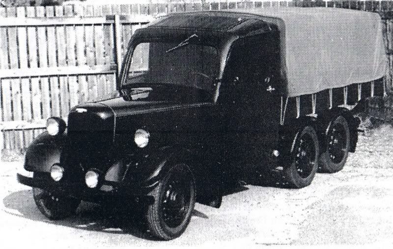

Heres the rest of the artical.
I do know of a actual 4WD bradford that was made to go off road etc. was not road legal. I think it had a a sprocket and chain driving the rear wneels

The Bradford man
Posts: 165
Joined: Sun Feb 04, 2007 2:54 am
Your interest in the forum: Jowetts, Subarus, Any thing with a Boxer engine.
Given Name: James
Location: CHRISTCHURCH, NEW ZEALAND
Post by The Bradford man »
Peter Holden wrote:well lets see some photo and a bit of a write up. I'm sitting here in front of this computer with bated breath!
Do you mean the one that started with this thread or the one that i know of?
The one I Know of was built in the 1970s or even early 1980s.
Dad took a pic of it. I will had to ask dad more details since he knew who built it.

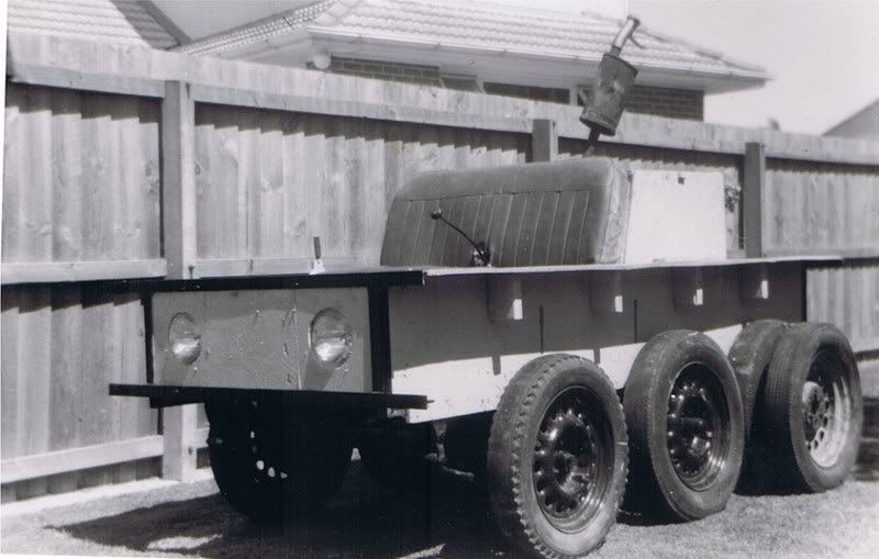

Heres pics of the home built 6wheel 4WD Bradford
info so far on this home built:
Its fitted with CC engine, Twin Gearboxs.
Has the two diffs facing each other with short driveshaft inbetween.
on the short drive shaft it has the sprocket with chains going up to the gearbox above. It used to Brake chains alot .
