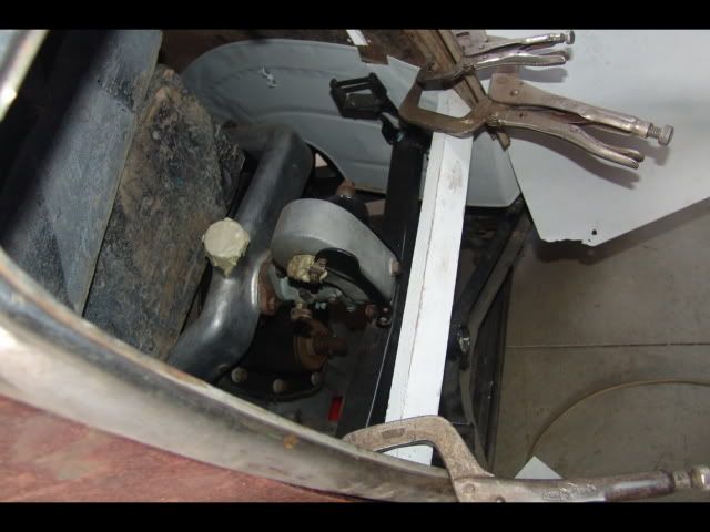

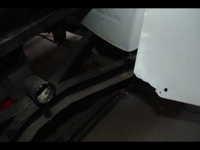

Heres some pics... so any one have pics of the missing part?
Thanks
James~

Hello Bradford man.
Tonight I had a look at a friend's 1935 saloon.
The forwardmost 'girder' of the front cross brace has two holes drilled into the top flange equidistant from the starting handle steady tube.
One of these can be seen clearly in your first photo next to the edge of the wing on the LHS.
If you are using the original Jowett radiator, then the holes in the supporting flanges at the bottom of each side of the rad should correspond to the holes in the cross brace. Some people use a rubber washer between the flanges and the cross tube to help reduce vibration.
The flanges point to the rear of the rad. as do the outlet pipes and the header tank.
The rear face of the radiator is vertical. The stainless steel cowl (surround) is at an angle and is attached to the sides of the radiator by thin sheet metal plates soldered to the surround and the sides of the rad on the car I inspected.
There may be other ways of fitting the cowl.
The false honeycomb will need to be attached to the cowl first.
Little sketch attached below. May have a photo or two later if B worked his new camera phone correctly.
