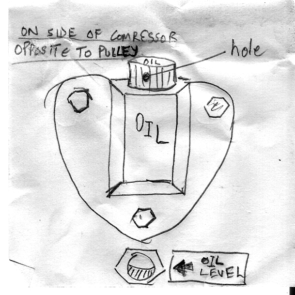

Recently, after turning on and up to pressure, when turned off it loses air through a little hole in the filler cap for the oil bath:-
The hole is manufactured, not due to misuse.

The next time I used the compressor I let it run up from 0 to 100psi again and blew tyres up etc. When I'd finished, there was still around 70psi in the tank, but I heard a slight sound of air escaping and traced it to the little hole in the oil filler cap.
I don't want just to seal-up the hole as it must be there for a purpose, but wondered if there's anything else in the oil filler/level fitment that might have perished.
