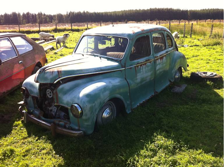

Surtees obviously had the suspension lowered to get some downforce.

Never had you down as the master of understatement, Drummond. Isn't the lack of an engine something of a problem???

That early ('ridged' bumper, small headlights) Javelin looks worthy of closer inspection, if only for spares! Has the chassis number been passed to the Registrar?
That said, it is in much better general condition than my Long Four was when I got it!
With Dennis Sparrow's chassis front ends, and some generally straightforward chassis work, many otherwise dying Javelins can be recovered. They don't make them anymore you know.

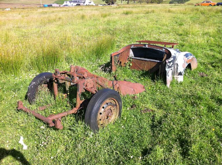

Yes it will!!!Jack wrote:Drummond, you have e-mail.
And before anybody suggests it - No, that will not polish out.
Chris, where are you when we need you to attend to a thread...?
Quite a collection you've found there Drums, do let us know their fate. It would be nice to see them go to somewhere where a little bit (ok, maybe a lot) of TLC will do them proud.

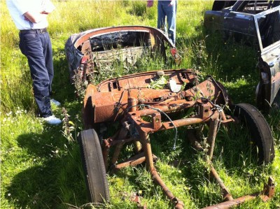

I wonder what Jack's mail to Drummond is - the reason I am curious is that I think Jack may be planning to add to my already overstretched work load - (I could be wrong) - without some outer panels it would hard to piece the Jup back together but if the chassis is not too far gone it would make a great start for a special bodied project (something I have always wanted to do)
