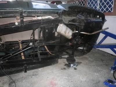

The team removed the engine & gearbox
along with the interior trim & floor Meanwhile I fabricated brackets in order to mount the car to the turning jig 27 Long 4 Tourer Oily Rag
Re: Early Javelin Restoration
With the jig mountings in place and the wheels removed off the car - plus a little shuffle here and there to clear the roof beams of the workshop - over she went
Giving us clear access to the underside of the car All quite solid but some frightening finds in places - more to follow soon27 Long 4 Tourer Oily Rag
