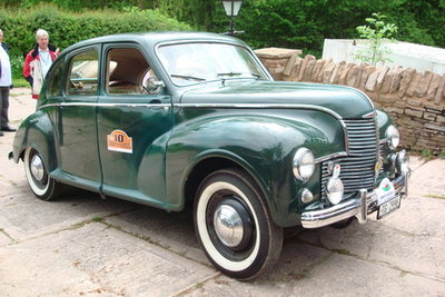

This is a early - 1950 - Javelin - originally exported to New Zealand but purchased by fellow JCC member Peter Pfister a few years ago and shipped from NZ to Peters home country of Switzerland. The car has several very early details which could indicate that the car was probably built in 1949. Peter brought the car over to the UK this May for the JCC annual rally but left it in the workshop of Keith Clements for a through restoration. The plan being that Keith will handle the mechanicals & oily bits - I will attend to the body shell / paint & shiney bits, Jack & Amy will help out where they can, and Peter will help on the occasions that he comes over to the UK.
Although the car looks very nice in the image it has seen some life over the years, it has a basicly sound bodyshell but doors have gaps that you could drive a bus through in places - on the other hand in other places the gaps are so tight that the paint gets taken off when you close the door. The paint is several shades of green all over the car and underneath the paint are several areas of patch & bodge. The underside fairs no better with some of the mechanicals having seen various attempts of poor repairs over the years and there is some awful welding in places. We intend to post on a regular basis as we pick our way through the restoration process - please forgive the odd in house laugh that the team tend to exploit on occasions and feel free to join in the discussions

I do not think that the Javelin can possibly be a 1949. Mine was made in August 1950, and has the earlier Jowett badge on the front of the hood. Peter's also appears to have white side lamps; mine didn't have separate white lamps but are in the head lamps. What diameter are the headlights? Mine are 5.75 inch, but this one looks as if it has the later 7 inch ones.

Robin - The headlamps are 5.75 inch early type with the side lamps in the headlamps - the white lamps that you see in the lower part of the wing are a non factory - later fitment to give the car indicators - it was not unusual to have white lense indicators prior to the 1960's - there are various odd differences on this car to others of the same year thet tend to indicate that this is a very early car.

In the register there is an EOPB 6959 UK registered on 31 Dec 1949. There is an EOPB 9647 UK registered on 15th July 1950. We can be fairly sure that 9622 was made in the first half of 1950, going to NZ and unsold in a dealers showroom could take several months but 30/05/51 seems a long time unless it was a "demonstrator" ?
The headlights look rather larger than the early models but that must be just the photo! 7 inch lights were introduced in November 1950 starting with car engine number EO PC 11326 ( was that the car number too?) according to the Jowett technical information sheets. I think retrofitting 7" lamps would mean changing the wings as well, so not simple .

My chassis number is 10100 and it was shipped from England to Vancouver on August 21, 1950, so 9622 would be a bit earlier than mine. The cylinder heads have casting dates on them which could narrow the manufacturing date a bit closer. The Jowett badge is off a later model than mine, which made me start questioning the date.

There are several bits on the car that pose questions - I think some areas are later additions but a glove box lid like no other ever seen, unsure about the bonnet badge too, the grille is original and the bumpers are the early type - no doubt we will uncover other odds during the restoration but in general I do not think the factory had too many rules when building the cars - and they may have been some crossover items between standard & delux models.

Another way of chaecking the headlights is that with the larger lights the horizontal chrome strip between the light and the Grill is shorter.
