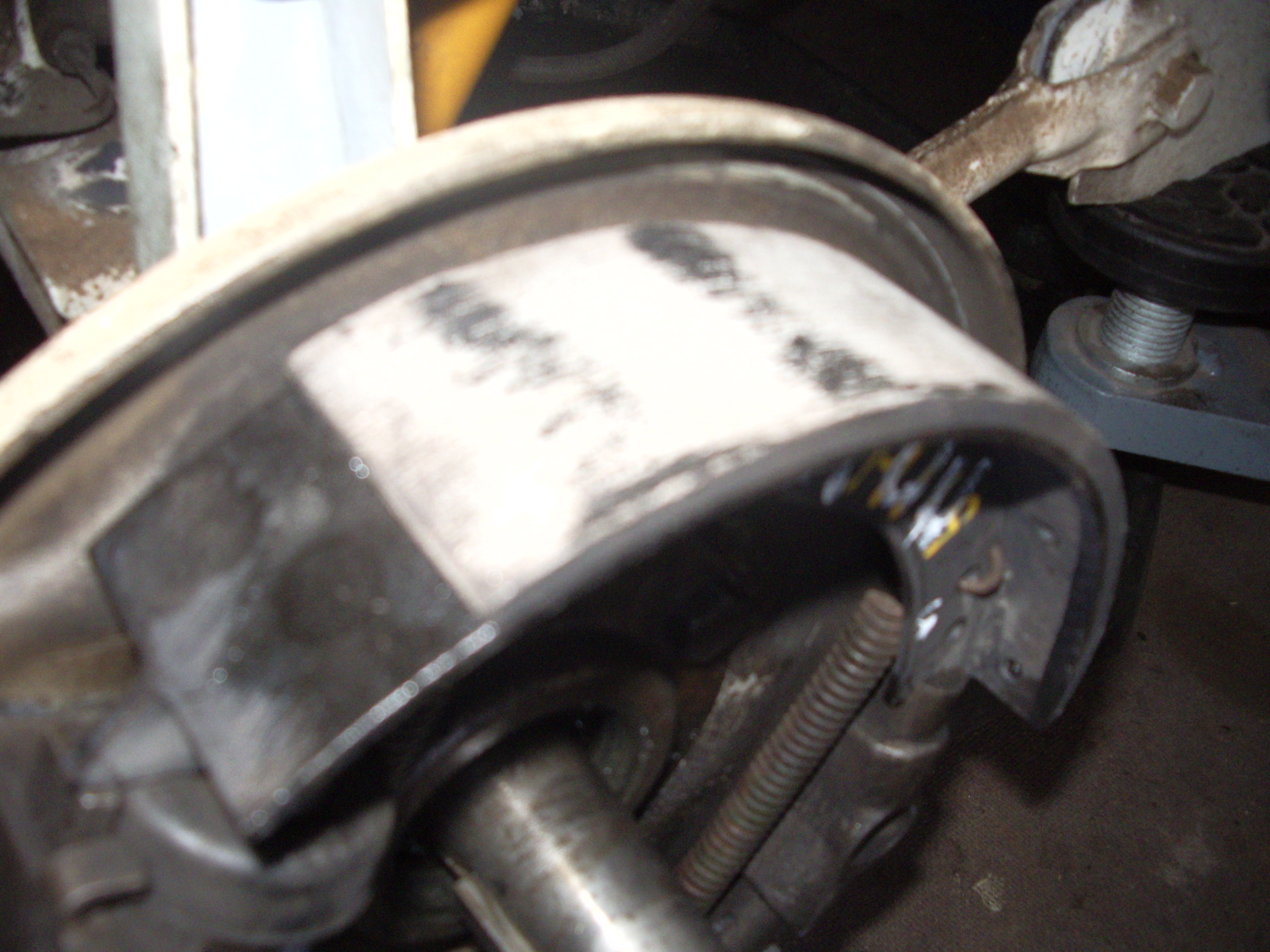

Inner oil seal on rear axle
Remember I said I had problems with a grabbing brake. Well inspection under lift showed oil coming from hub (no not grease). So we suspect the inner oil seal 3HA-27.

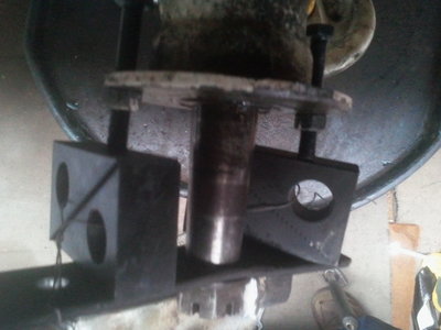

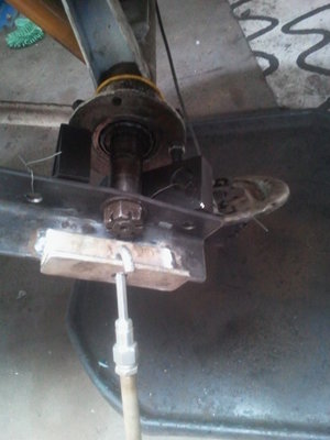

Half shaft puller
This digression from the original thread continues.
Here is the puller partly supplied by Trevor Spero and modified by us to take the slide hammer.
Then supplemented with a pushing arrangement from the clamping set for the miller ( the four stepped blocks) and two bolts providing the push. It would have been better to have the bolts with their heads against the block which is how I will do it next time!
When I get a 5inch cylinder of steel I will make a better puller!

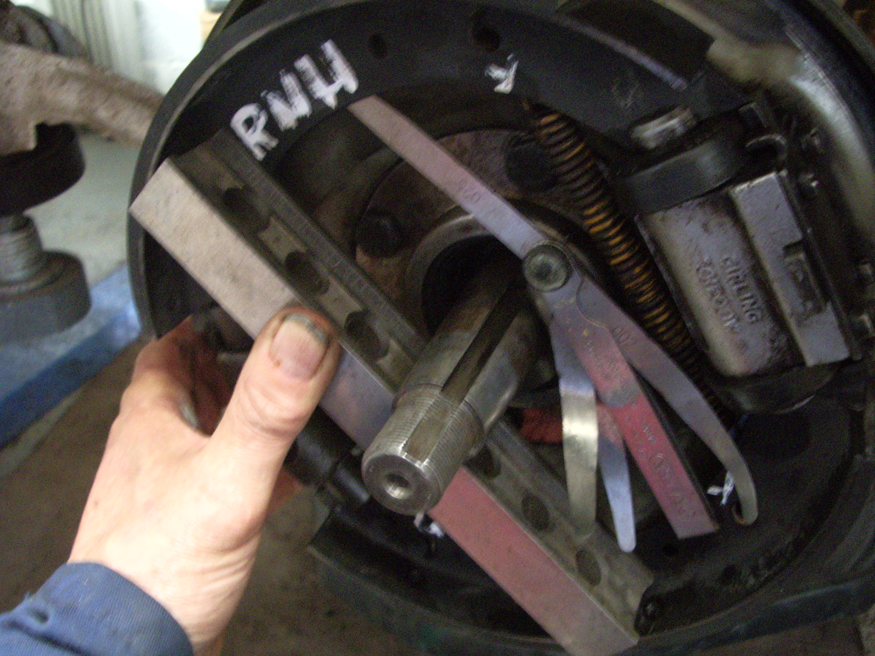

Brake shoe alignment
Having seen the uneven wear on one shoe I checked the alignment using a parallel bar and feeler gauges on top of the dimple on the backplate that positions the shoe. This was showing wear and had flattened. Sure enough it needed 35thou to bring the shoe back to the horizontal. This was checked by making sure the bar sat flat on the shoe web. The lower shoe need 20thou.
This shows the flattened dimple before being welded up.
This shows how a set of new shoes have bedded in. Nice and even. There is a bit more wear on the outer rim as the shoe now sits further out.
I subsequently put the drums on the lathe and took this slight ridge off.. See next post.

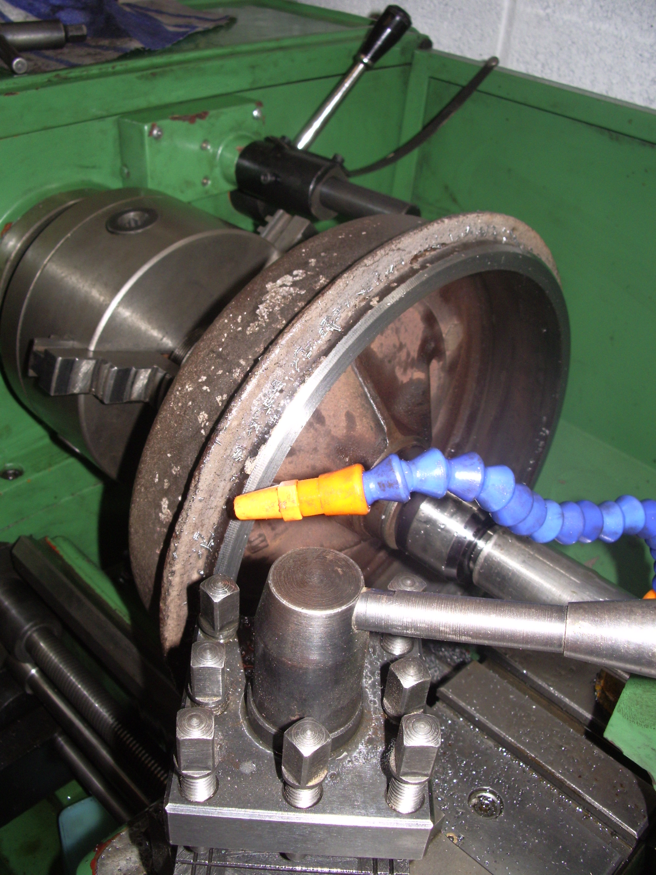

Shaving the brake drums
having now got the shoes sitting properly there was still a rubbing and this was traced to the drum fouling the back plate.
This had been a problem prior to all this work. So now I put the drums in the lathe and fixed it. It required a few trial fittings after each shave. I found the corners needed to be rounded both on the inside and outside. At the same time the ridge on the brake surface was also skimmed.
