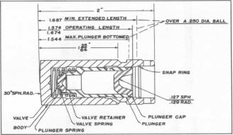

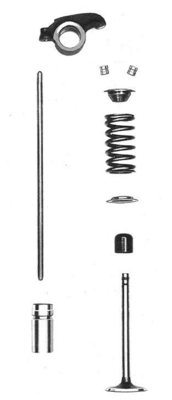

Hudson Service Information for the 1956 "Hornet" Special V-8 Series when used in conjunction with the Electrical Section of the 1956 "Rambler" Technical Service Manual and the 1956 Technical Service Manual Supplement.
Valve Tappets and Push Rods
The hydraulic valve tappet consists of a body, plunger, plunger return spring, check valve assembly, push rod socket, and lock ring (Fig. 4).
FIGURE 4—Sectional View of Hydraulic
Tappet Assembly
The tappet operates in a guide bore which has an oil passage drilled into the adjoining main oil galleries.
When the tappet is on the heel of the cam lobe, the plunger return spring indexes an oil hole undercut in the plunger with the oil supply admitted through the tappet body. Oil under pressure flows into the body- through the check valve assembly maintaining the tappet fully charged.
This cycle of operation occurs when tappet leaks off some oil during the normal valve opening events. Opening movement of the cam lobe causes tappet body movement, closing the check valve and transmitting "zero-lash" movement of the push rod to open the cylinder valve.
The valve tappets should be cleaned and serviced at time of engine overhaul or whenever excessive noise exists.
FIGURE 5—Valve, Push Rod, and Tappet
Assembly
When removing the tappets, they must be kept in an order that will insure replacement in their respective operating bores in the engine because they are select fitted to that bore. Keep each tappet component group by itself as all detail components are select fitted to one another in manufacturing.
Only complete tappet assemblies are supplied for service replacement.
The tappet assembly should be cleaned in a solvent to remove all varnish or leaded deposits. After cleaning, the tappet must be "leak-down" tested to insure its "zero-lash" operating ability. Kerosene should be used for this test. Test the tappet by filling the body with kerosene and then install the plunger return spring, plunger assembly, and push rod socket. Leave out snap ring for test. Insert the push rod in tappet socket and check it for "leak-down" by pushing downward on rod.
If the tappet leaks down rapidly or collapses immediately, it must be rechecked and/or replaced with a complete new tappet assembly. The normal tappet will take approximately 10-45 seconds to "leak-down" with kerosene with a 50 lb. load, travel of .125". After testing tappets, they should be pre-lubricated and assembled in the engine without an oil charge. They will normally charge themselves in 3 to 8 minutes of engine operation.
Tappet Assembly
Assembly

It is mildly interesting that Figure 4 above from the Hudson Hornet manual does not appear to have any means to adjust the "tappet" setting. Yes, even with hydraulic tappets you still need to adjust the setting so that the inner piston of the tappet is at the right part of its stroke when on the cam base circle.
