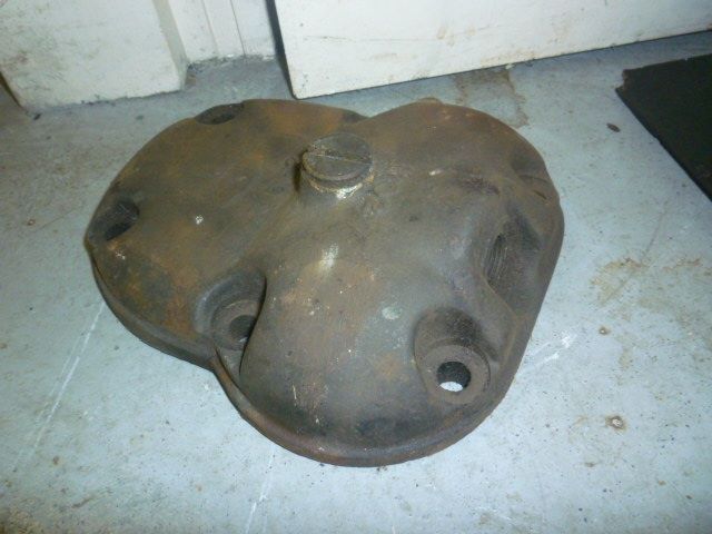

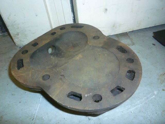

Cylinder head
What is it from? 1933? My cars are fixed head so this is surplus.
Looks OK. Offers?

Post 1930 7hp or 8hp. But which?
How to tell the difference - other than by direct comparison?
I have a feeling that the water passages are different shapes.
Are you there Tony / George?!

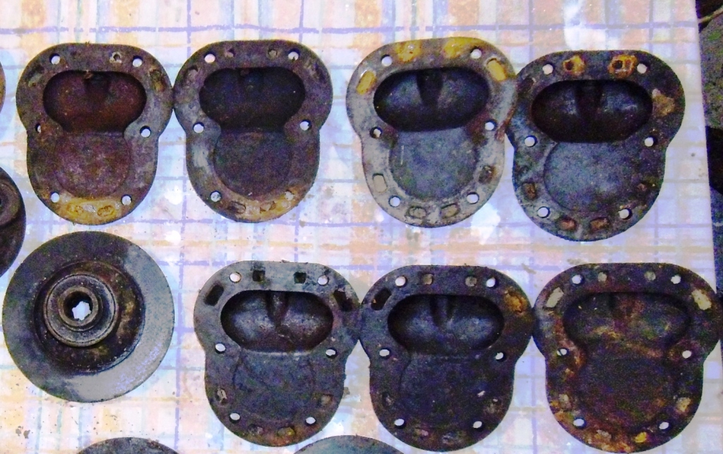

Ian wrote:Post 1930 7hp or 8hp. But which?
I'll have a go, but am willing to be corrected!
The head in James' post looks like an early 30's 7hp type. I suppose that the 8hp head is the same.
These are some similar heads in my spares.
P.S. They would look much better cleaned-up, but they are all waxoyled, and have been for decades!

I'll forgive yours for being dirty, if you'll forgive me.
You seem to have an odd 7. Mind is now wandering to a radial 7 engine..........no , stop that!
Are these things common as muck? Is the best use of mine as a door wedge?

Your lone cylinder head is identical to the one on my 1936 7 hp that I am rebuilding. I am missing one head, and the one I do have is cracked, and so I am interested in purchasing yours. I will PM you with my offer.
