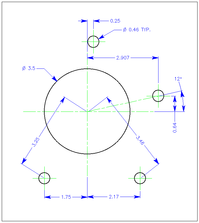

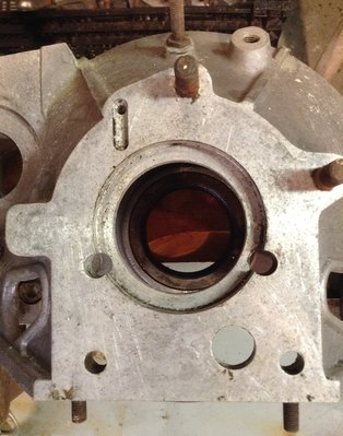

So, does anyone have a factory drawing of the Javelin/Jupiter gearbox housing and/or the clutch housing? I am particularly interested in the bolt/stud spacing at the interface between clutch housing [see photo] and the gearbox and also the stud spacing at the interface between gearbox housing and the tail shaft extension housing. In both cases, the stud locations appear to be awkward non-obvious dimensions, and while I have made measurements and got it about right [see sketch], it would be much better to actually go to the oracle and get it right.
In the case of the clutch housing to gearbox interface, I am drawing up a workshop fixture (which I will share here when it is done) to hold the gearbox during overhaul. Likewise accurate knowledge of the back face of the gearbox housing is necessary if one wants to make an overdrive adapter ring. Taking dimensions off the [manufacturing] drawing would be the easiest solution if the relevant drawings are available. If not, does anyone have access to a Faro Arm or similar: http://www.faro.com/en-us/products/metr ... m/overview ?
