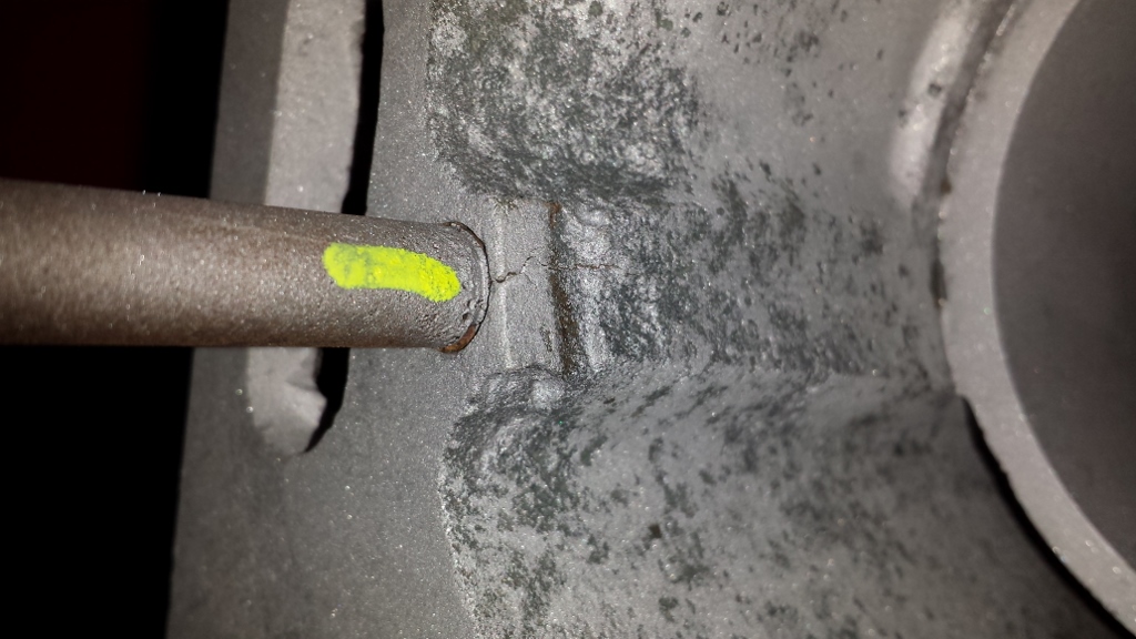

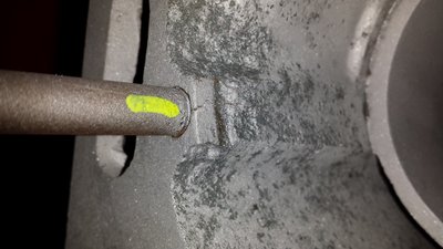

Showing the cracks around some studs.

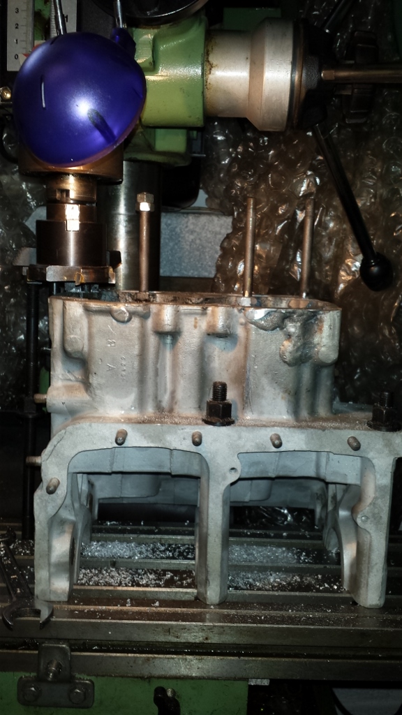

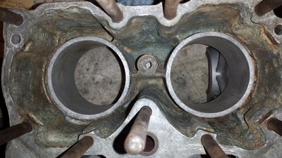

On the milling machine after welding with ER4043 4% silicon filler.
A test was done on an old water pump to check on flow and cleaning.
TIG was set to AC with 70% positive balance to try to clean out any remaining oxide after degreasing, sandblasting and stainless steel wire brushing. A 3.4mm electrode tip was used to cope with the increased temperature in the tip due to the positive bias. A pass without filler was used as part of the cleaning process to try to get a decent oxide free pool. 2.4mm filler was used. The foot pedal was used to control current which peaked at 150A. The block was not pre-heated as (I learnt) this can ruin the strength of the block. The block was not allowed to cool quickly to reduce cracking. Short passes were done to keep temperature of block below 350F, checked with a heat gun.
To prevent sag of the web it was supported. I used a thick piece if steel. Next time I will try a bed of sand.
Obviously learnt a lot first time around and it did take a long time getting the right tools and settings together particularly on the milling machine. The block needed to be clamped in four corners to get it level, but amazingly it was parallel once this was done. I checked with feeler gauge on mill tool, after a rough check with dial micrometer. The 'old motto' measure at least twice!
I did try to remove the stud but it would not budge even after the heat of welding. I thought it best to work around it!
I think I managed to get a reasonable weld but with such old contaminated metal there will be some porosity or bubbles and some grain boundaries and cracks. There is still some corrosion further inside but this is difficult to get to. I did patch up corrosion where the cylinder liner seal was getting narrow. Machining this piston liner face proved to be a challenge, particularly as some of the studs were not removed. It required removing the depth gauge on the milling machine so the head would move low enough. As did machining the face that locates the top of the liner, as it was so close to the stud and required a long large reamer and a selection of Morse taper converters.
Crack detection.
There are a few stages to this process.
The first is to thoroughly clean, compressed air blow out and then apply the special cleaner supplied with the pack of three aerosols. Paper towel was used to assist this process.
The blocks were then warmed on the wood burner to 20C as they had been around 7C.
The red indicator fluid was then sprayed onto all surfaces. Whilst this was finding its way into the cracks I went in search of UV lamps (finding a SAD lamp and two fly killers that contained UV lights). The reason is the indicator shows up better in daylight. I need not have bothered as the sun started to shine onto the work place! After 20 minutes the indicator was cleaned off using paper towel with the aerosol cleaner applied. Then the third aerosol containing chalk was applied and left for 10 minutes.
Although the indicator did show up in many places, this was often caused by poor cleaning before applying the chalk. Some of the porous bits that showed up were not thought to be serious enough for rework but one stud hole that had been welded with the stud in place was not good. So the stud was cut off with a grinder as it had refused all attempts to be unscrewed. The surface was faced with a mill and centered before drilling out the core of the stud. A stud extractor was tried part way through this process but that did not work either. So the next size drill was put through and the remains of the threads removed with a start tap and then finish tap.
Now, with all traces of steel removed, the crack was ground out and rewelded. It was much easier this time without the contamination from the steel stud and any crud around the thread. Unfortunately the block had been removed to do this welding so the mill had to be realigned to drill the new stud hole. After coersion from Peter Pfister I decided to put a helicoil in rather than just rethreading. The helicoil is about 40% stronger than a thread in the aluminium but it does require a larger hole, reducing the amount of metal between the stud hole and the water jacket which is very thin where it meets the liner.
All areas were checked for cracks and porous holes, so hopefully the blocks are now good enough.

Repairing the oil housing thread.
Well this really did take longer than it should, but I treated as an exercise in measurement.
First job was to adjust the engineers spirit level which is potentially extremely accurate. Ok it may not be up to the latest electronic gizmo standards but I reckon it is good for 1 thou in 10 inches. I did this with my dad's ground parallel bars to obtain a flat surface and attempted to find the most stable surface I could which was the 2 inch thick workbench. I found if I leaned on this the level would detect the movement! It was adjusted with a pair of nuts at one end so it read the same when rotated through 180deg. Then a thou shim was added under one end of the parallel bar to level it and then the process was repeated.
The lathe and then the mill were levelled again. A 1mm shim at one end of a 4ft lathe was enough to move the level a graduation.
It was very important to clean all surfaces as the smallest piece of dirt would throw out the level.
With the mill bed now level in both directions the block was mounted and wedges put under until it was level on the oil housing face. The adjustment was checked with the dial gauge.

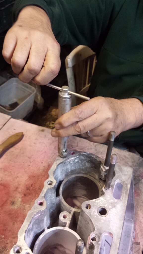

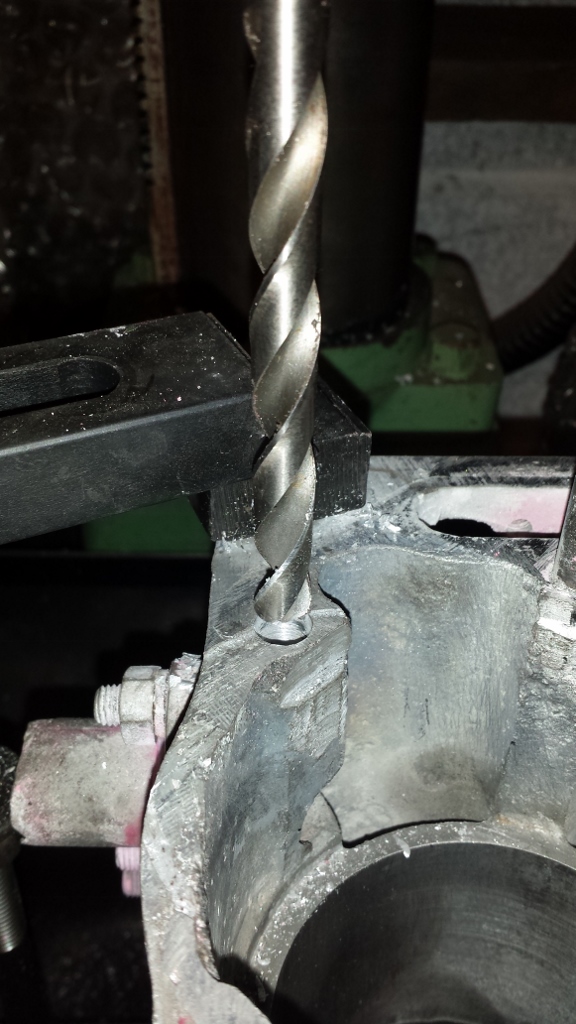

Thread repair.
Having spent an inordinate amout of time levelling the milling machine I then set about checking the set up of the block before centring the tapping drill for the helicoil. This I did first with a drill about the core size of the existing thread and then with the tapping drill in place I checked its cutting edges did not deflect when lowered slowly into the hole. Is there any other trick to do this?
Then the depth stop was set up using a depth vernier.
The tap was put into the mill chuck which was turned by hand to start the thread perfectly vertical.
Then the tapping was continued by hand with the chuck released.
The helicoil was then inserted by the special tool that drives the coil into a threaded cone to compress it radially.
So now the blocks are ready for cleaning. After the operation I checked the level of the mill and found it needed a 10thou shim under one corner. I also checked the lathe to the same accuracy and that needed a couple of shims under two corners. So then I cemented under both machines so that they do not move around. If there is any settling in future I can still insert some shims but it may take some jackin up of the bed rather than the base. Perhaps i should have put bolts in the floor and devised a method of having screw adjustment.
