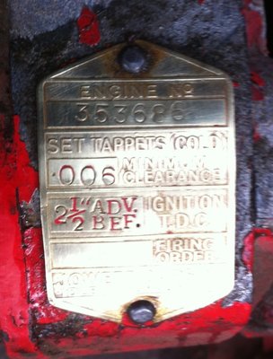

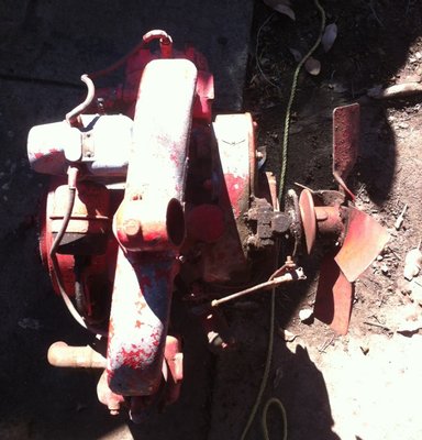

Is this what I think it is: industrial version of a 7 hp Jowett using Wico magneto ignition? Engine no: 353686, which would be 1933 build.
More photos in next post.Andrew Henshall

I can't help other than that is not a CC Bradford intake manifold (I've not noticed the CA or CB being different) - the carb is on top centre of the Bradford intake and the water hose (assuming that is a water hose) is offset on the Bradford engine.
Re: Help needed to identify engine
Hi Andrew, From the photos, this engine look exactly like my war-time Jowett stationary engine. The carburettor is under slung beneath the inlet manifold, so it becomes an up draught carburettor. The ignition is by magneto, housed within that light aluminium housing. The plug leads were screened, just like yours. Unusually for these engines, there is a bypass oil filter, using a metal can type of filter housing.
My engine is in a frame and drives a 120v DC generator.However, I know that these engines were used to drive a whole load of requirements for the War Office. I have one which has a MASSIVE flywheel, driving a multi-veebelt assembly which I believe ran a saw bench.

Thanks for the info David; can you provide the engine number on your engine please so I can compare it to the engine number on the "red" engine (353686)?David Morris wrote:Hi Andrew, From the photos, this engine look exactly like my war-time Jowett stationary engine. David
I am confused by the fact that the engine number 353686 is in the sequence for the 1933 7 hp cars, yet these war production engines were built 1939 - 1945. Could we be misinterpreting the engine number and it is actually a 1943 build engine?
Referring to the JCL publication "War Production Record", there were both 4 kW (5.5 hp) and 5 kW (6.7 hp) versions of the Generating sets, plus 1,762 2-cyl engines of unspecified output as well. Not sure how I determine which version the "red" engine is. Presumably these were all water cooled, as the air cooled versions are listed separately in the JCL publication.

Thanks Jack, I too compared the intake manifold on the "red" engine to a photo I had of a CC Bradford engine, and saw that it was not the same in many ways. I don't have a photo of a CB engine, and there are no CA Bradfords in Australia as far as we are aware. It is very different to the intake manifold on my 1936 7 hp engine. Is it perhaps unique to the war production stationary engines?Jack wrote:I can't help other than that is not a CC Bradford intake manifold (I've not noticed the CA or CB being different) Jack.
The cylinder head has a flat form unlike the "bulge" that the heads on my 1936 engine display, so it is much more like a Bradford engine in this regard. The Bradford heads I've seen all have a large screw-in plug with screwdriver slot just below the spark plug recess, but the heads on the "red" engine don't have this feature. Very confusing to me as a "non-Bradford" person.

Could that leading '3' indicate 1943? Then this would be engine number 53686 which looks about right for that year.
I had a similar engine some years ago and that too had a massive flywheel with Vee and flat pulleys and which also incorporated a centrifugal clutch - again possibly to allow starting 'on load' such as a sawbwnch as suggested earlier.

All very interesting - I own 353818 which is only 132 numbers on from Andrew's engine and from a first look they are identical - images below
- Apparently it did run several years ago - I will in time get it running and providing it runs well give it a cosmetic restoration with a new trolley / radiator & fuel tank (old one is non original and leaks) - apparently the fuel tanks were more of a oblong with radius corners - I will see what I can pick up from the auto jumbles but if not I will have to make one - I don't think the rad is original either - I have had a rough measure up and a Javelin rad would be well suited - I have several other projects to complete first so it is in storage for the present time being.27 Long 4 Tourer Oily Rag

the ''3'' indicates 1943 the sequence starting with '0' for 1940 ( a sample 1940 engine number being 051274
The cylinders and heads are similar to those introduced for 1940 model year cars in Aug 1939 wich in turn were more or less the same as CA/ b Bradfords ( the 1940 cars had alloy heads with plug facing outwards towards the inner wing)
The induction pipe to pot joint is the same 4 stud type as introduced in 1940 and continued on CA/CB Bradfords.
The induction pipe is however completely different in that ,whilst similar to the CB Bradford it had the carb attached below i.e. an updraft carb presumably used to prevent or reduce the chance of flooding.
A similar (maybe identical?) 'updraft induction pipe was also used on Jowett engine Bristol tractors , initialy with 2 stud fixing as on 1930's cars and then with aforementioned 4 stud fixing
