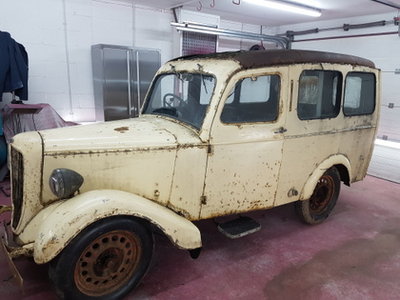

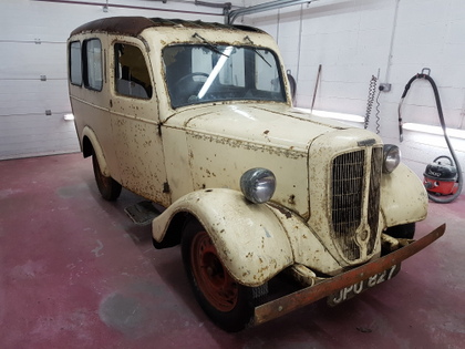

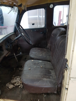

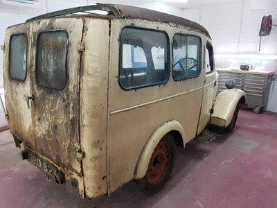

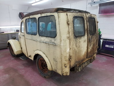

I have a 1947 Bradford Utility (6 light) in for body & paint restoration - it was rescued by Tim Brown after lying forlorn in a damp garage for over 35 years - it's fairly sound and arrived with me direct from a mechanical referb
Although the roof has seen better days 27 Long 4 Tourer Oily Rag

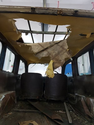

And I think the headlining may require a little attention Rear doors & panels removed Spare wheel carrier requires replacement

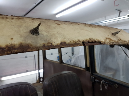

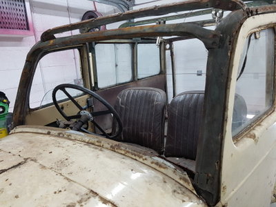

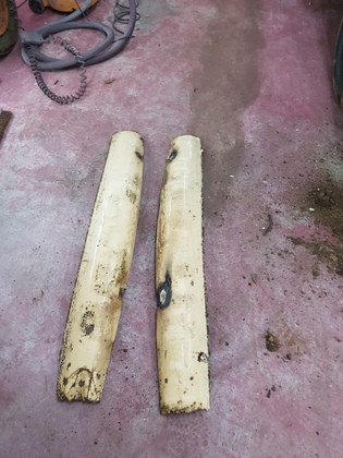

Rear corner panels will go again but require fabrication work to upper & lower edges to remove the rust perforated metal Roof laths will require replacement but the cross rails are good with the exception of one Roof side radius panels will require a fair bit of work to make them go again

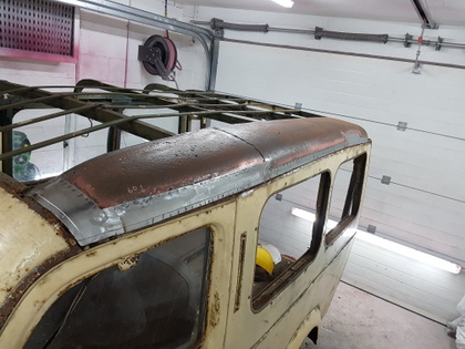

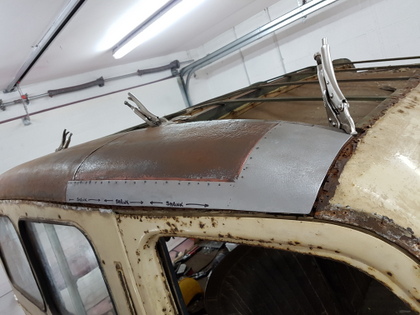

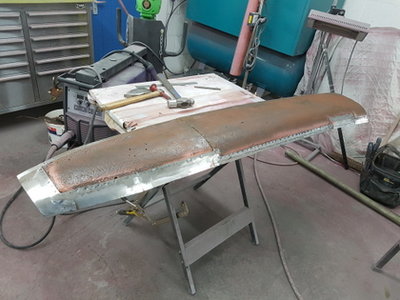

Made a start on the radius roof panels

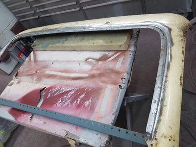

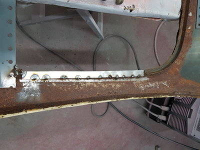

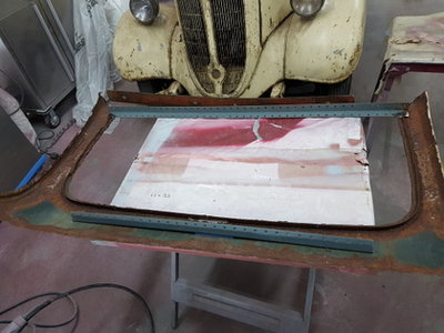

The front windscreen aperture panel is in a mess I cut the panel at the bottom of the windscreen pillars and then drilled out the rusty screws securing the panel to the ash frame - then eased the panel off the frame
Re: 1947 Bradford Restoration

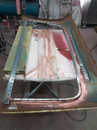

I braced the panel up with a couple of lengths of angle iron before commencing the repairs
Then started by replacing the windscreen aperture edges to the pillars first The aperture edge was welded to the existing panel once the rust effected edge was removed and a new return edge was spotwelded to the new steel (replicating the same process that Jowett employed when assembling the van from new) The old / rusted section that was removed can be seen alongside27 Long 4 Tourer Oily Rag
Once I had completed the aperture repairs to the pillars I utilised the same process as previously outlined to replace the top edge of the aperture
Still the edge of the panel along the adjoining roof line and the sides of the windscreen pillars to undertake yet27 Long 4 Tourer Oily Rag
I think this is a Bradford utility rather than a utility delux. Similar vehicle on an auction site 12 months or so ago complete with the same steering wheel. Possibly you could up-spec your Bradford utility as you wished.
Having completed similar repairs to my Bradford window surround some years ago my only comment is that I would have left spot-welding in the reinforcing holding flange until after the screen had been trial fitted. I would have then marked the settled position of the rubber and spot welded in the return to suit. As it was and after the car was painted etc I had a hideous task getting the screen in. I think the scuttle may move during the fitting process and the new rubbers may be slightly larger than the originals. Only my view, and I remain in total admiration of the skill and craftsmanship of Chris Spencer.
Rich

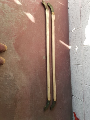

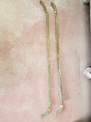

Two of the timber roof rails were dead
So with a piece of ash to hand I machined down the replacements and managed to salvage the original radius ends Repaired rails fitted along with new roof laths 27 Long 4 Tourer Oily Rag
