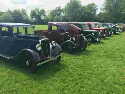

This is the way I did it. I think that the only reference that I had at the time was a sketch picture.
I decided where to put the back of the cab by setting up the drivers seat in a comfortable position.
then building around it. I could so with another 6" in reality, it really depends on the seating. At the time
I fitted Hillman Imp seats which were fairly compact. I now have Triumph Acclaim ones in which are bulkier.
Up to the rear door post the shape is original,I then made a second frame the same shape and set it about 6" further back. with the back cross frames another 6" or so further back
The side frames then blend to flat across the back. From the door I made all new panels from aluminum all of which were hand formed,
there being 6 in all, so a little different from a completely original vehicle.
