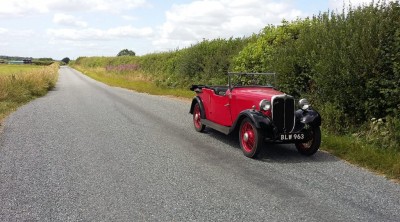

I have had the weasel out for a brief road test yesterday evening. All four gears are there, Tony you were right there is quite a bit of wear in the groove for the bolt/peg in the side of the tower. With the spare gearbox I have, I'm planning to swap over the levers as my spare has little wear from what I can see.
Getting there slowly. An air leak from the joint between manifold and the carburettor to sort out, as I've checked the faces both are flat its quite intriguing that when I squirt around the joint to test for a leak, it appear some is still getting in where it shouldn't. Interesting point there is stamp in the casting on the face just below the carb bolt of JCL 15. I haven't seen this before on any other manifolds. Are these the remade ones from JCS?

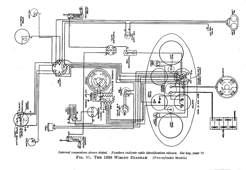

Things have been moving on. Have been out on short runs and so far going well, after finding it performing quite "flat" I checked the timing between the camshaft gear and crankshaft gear. I found it to be two teeth out, changed it over to being back in line and now on par performance with my Saloon.
So my next question is has anyone had a petrol gauge apart, I've recently got into the sender unit on the tank to find it seized solid. Now I've freed it off, the next step is the gauge after testing it on a battery, I've found it only reads to Empty when connected to a battery, where there should be no resistance from the sender while its not connected. The casing should also be earthed, which I have done. Has anyone got a wiring diagram for the gauge? So I can have a bit more of look into it.
Re: Weasel Tinkering
Have you voltmeter which will read resistance? If not use an incandescent bulb in series with your battery .
Both the petrol gauge and the tank sender unit will have a resistance. The tank sender resistance will vary with position. First check the resistance of the sender by disconnecting the wire from the sender at the gauge. As you say you need to have the sender return connected to the chassis earth of the battery.
The illumination of the bulb will vary with position of sender.
Your gauge should also have a resistance which you should check. You could do this by using your bulb connected to the sender side of the gauge with the other side of the bulb going to earth with the gauge being fed by battery voltage. I do not know what sort of gauge you have. It may be moving iron or bimetal both of which measure the current going through the sender.
